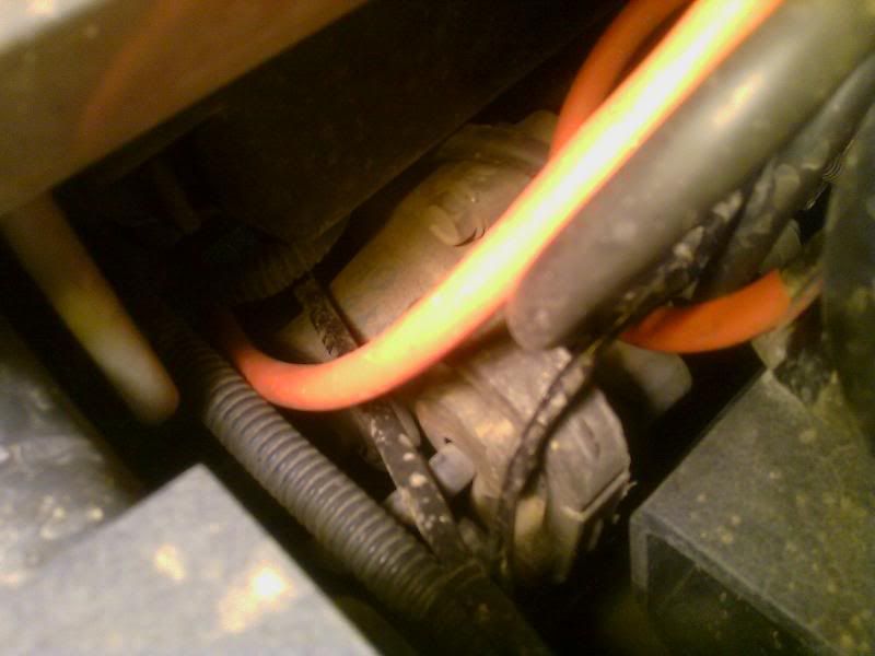

The one I'm wondering about is my edisco motor. I can rotate it by hand just a little bit. Maybe an 1/8 of an inch. And it looks like the rubber "stabilizer" (I'm not sure what to call it.) has some play in the hole where the metal rod goes through. I've got a picture:
Could this cause loose steering and a heavy clunk in the floorboards?

Does anyone know if there should be any play in the edisco motor? I feel like that rubber isolator should be tight to do its job, but it looks like the hole with the pin going through it is wallowed out.
