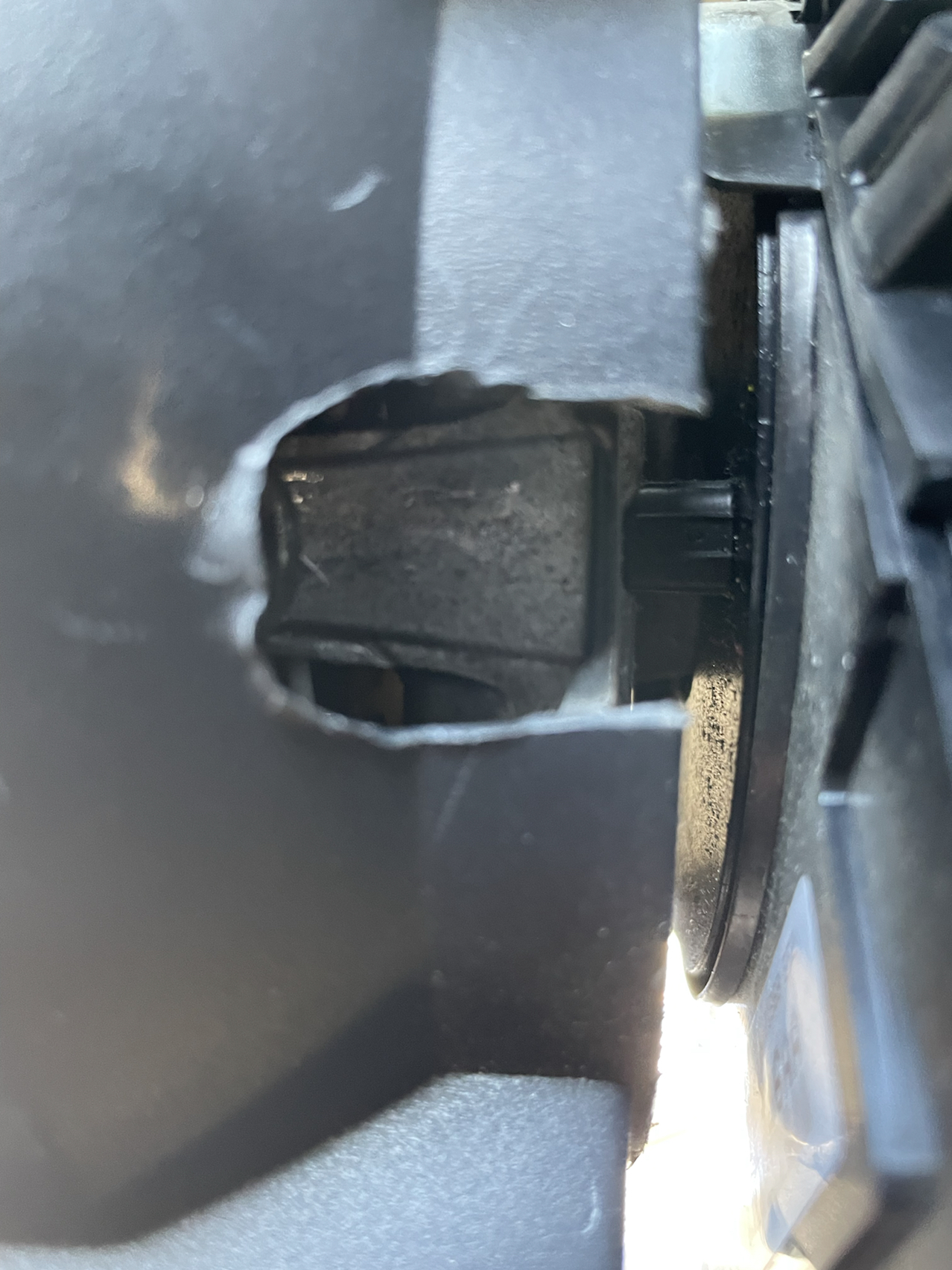

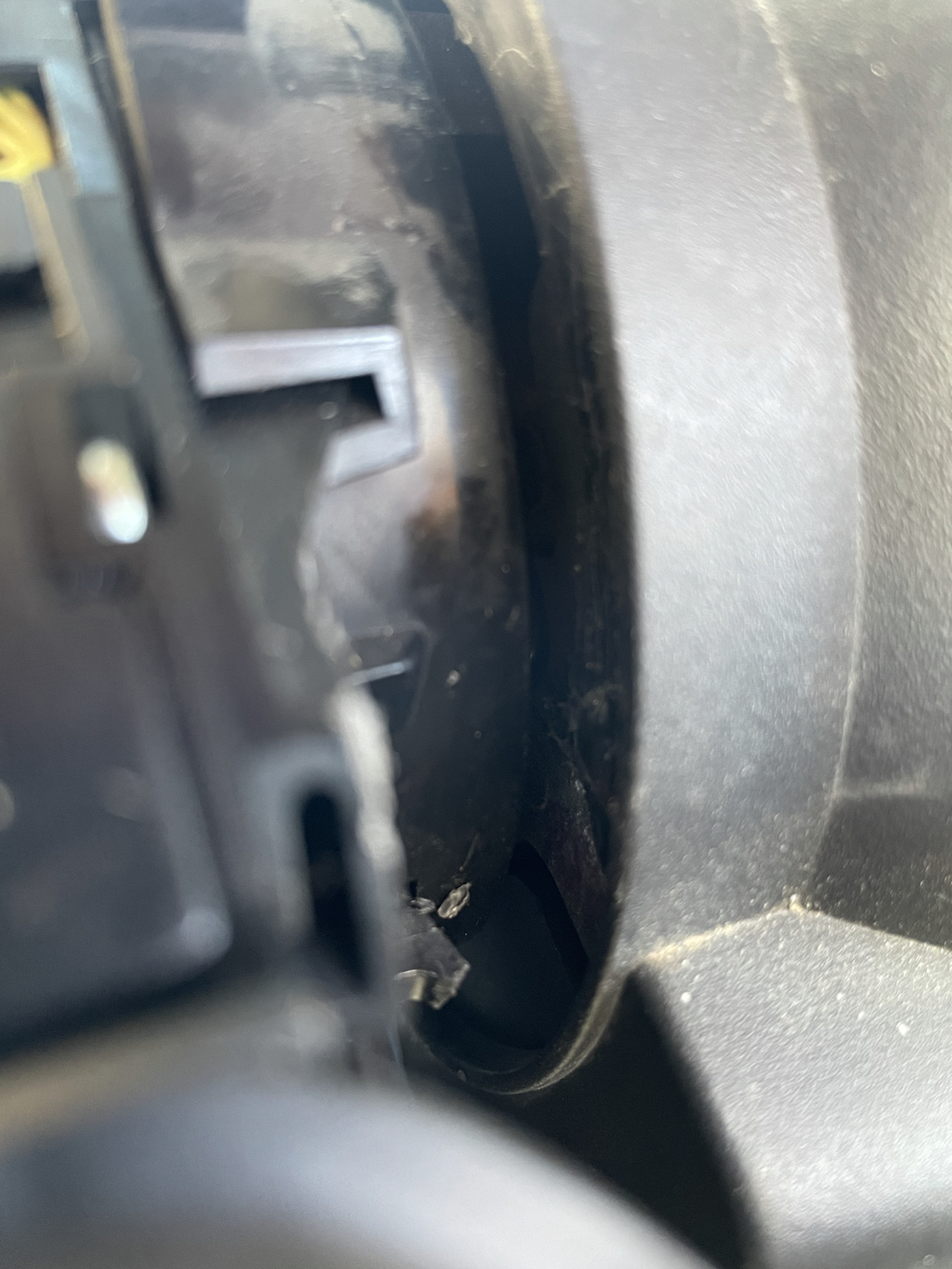

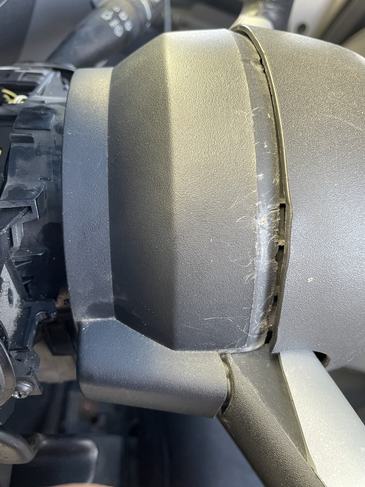

I'm trying to remove the airbag to replace my clock spring and I have now wasted 2.5 hours just trying to get the airbag off. This seems impossible. I'm able to get the bottom one off no problem because it has a slot but the top has no slot like shown in many videos. And will not come off. I have no idea where to even place the 90 degree screw driver as I'm just guessing and scratching and breaking more stuff. I
At the 2:00 minute mark, he shows the screwdriver they he altered so I will try and use that for sure and at 1:51 you can see he points to the openings on the plastic part to insert a screwdriver tool into. I simply do not have those holes. I have the bottom one but they top at 10 oclock and 2 oclock i don't have. One of the last pictures is from above with the steering wheel straight to show I don't have the holes and the final picture is where I think the actual hole is but it's just a guess.

There should be three at 120* apart. So to reference a clock face it would be 10/2/6. Who butchered those holes for the airbag mounts? And are you doing the clock spring upgrade or does the Jeep have it already? I remember the video stating that it is more difficult to go back in after the upgrade due to the new shroud design.

I unfortunately destroyed it like an idiot. The Jeep had it done already under the recall about 3-4 years ago. My first one had no issues but I got the recall and the dealer did it free of charge. The one they put in failed within 4 years. Now no longer covered under the recall warranty and I'm on my own. This would definitely explain why my shroud looks so different than the videos.
