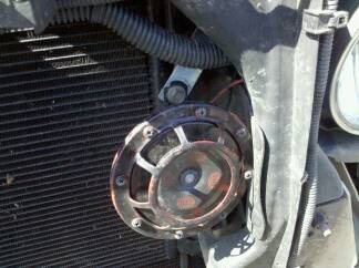

Any chance you could show a picture of where / how you mounted your Hella Horns. I have looked and didn't see an obvious place.
Old Aug 2, 2010 | 06:27 AM
  #27
rinkishJK's Avatar
Joined: Jul 2009
Posts: 4,038
From: NORTH JERSEY
Default Re: Horn isn't working?
I ditched my stock one after it got wet n sounded like a dead duck! I like the plastic bag idea!! I got a set of hella horns and its a lot better tha
One is in the stock spot behind driver light...
Sent from my Droid

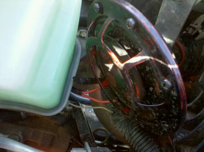

The other is behind grille on driver side.
Just used a scrap piece of metal to mount the mount it comes with to.

From: NORTH JERSEY
Forgot pic in last post... sorry.
Sent from my Droid
