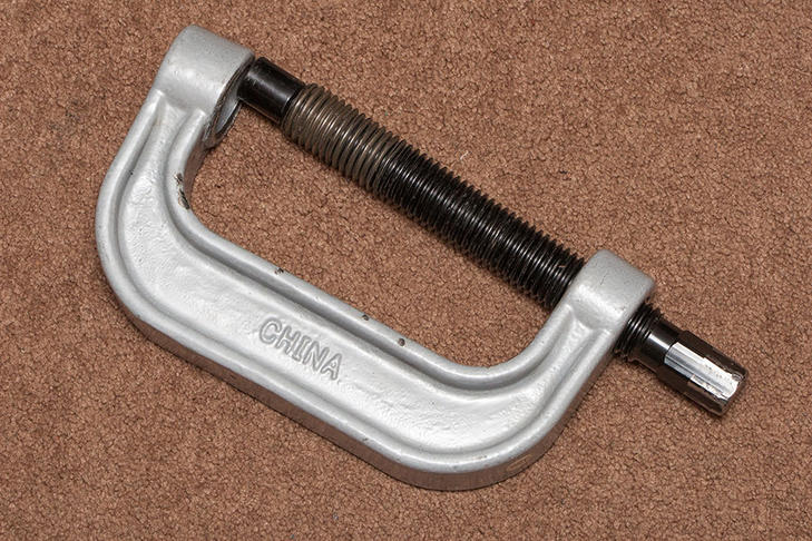

I haven't pressed in the new BJ's yet, and will leave it for the weekend. In the meantime it seems like I bent the press after I was done with the upper BJ:
Do you guys think I'll be fine pressing in new BJ's with this press? Or should I get a new one? I was able to push the old ones "fine" even with it bent like this.
