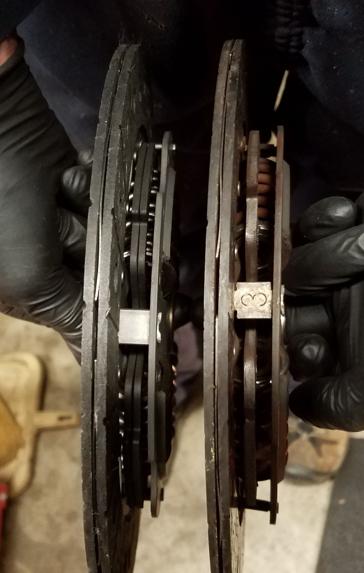

Default Loose Clutch Disk Inards...
TOB felt pretty dry, but most of the noise in mine was loose/worn clutch disk inards. The center spline had lots of rotational slop, the part that pushed on the springs had about 3/16" of wear - metal missing. This part was rattling around inside when when the clutched was depressed, with the clutch engaged the slop was taken up. The springs feel weak too, just about ready for complete failure..
Turns out the original clutch was made by Sachs, and to me this looks like a weak design. First thought was I should have ordered a Luk, second thought was compare the new Sachs with the OEM Sachs. In the pic, note how they now have a "doubler" to increase the surface area against the springs.

Old Apr 26, 2018 | 04:07 AM
  #49
HostileJK's Avatar
5 Year Member
Joined: Oct 2017
Posts: 73
Likes: 6
From: Iowa
That looks just like the one I took out and yeah everything was worn down and loose, especially the double springs almost to the point I could just about pull one out. I'll grab a picture before I throw it away.
