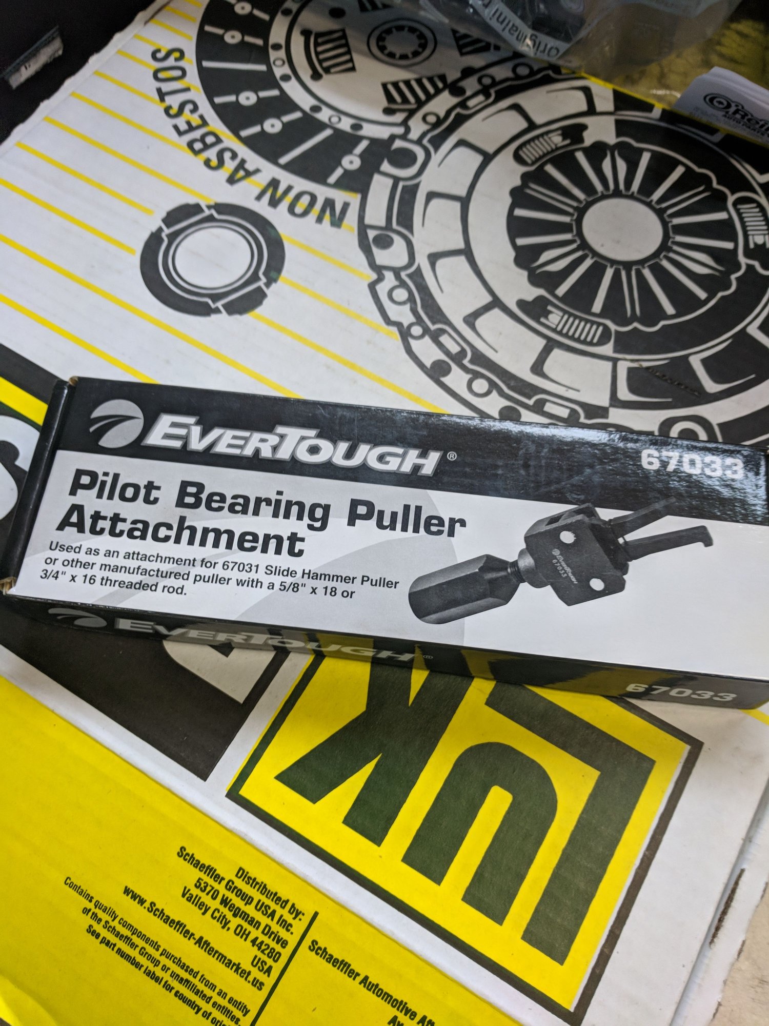

While the garage is warming up and I am have a Dew to wake up, here is the parts I will be putting in and a comparison between the crappy plastic lined throw out bearing that comes with the Luck kit and the National bearing I picked up as well as a shot of the parts that comes with the kit. Also a shot of the shoulder bolts outlined in the paper I posted above.

2nd picture there, whose bearing is that? It looks nothing like the Mopar I took out or the National I put in. I'm looking at the SKF next as my National is noisy.....again.

The second picture is the one that came with the luk kit, although I was surprised to see the one I removed today looks like a National 😲
