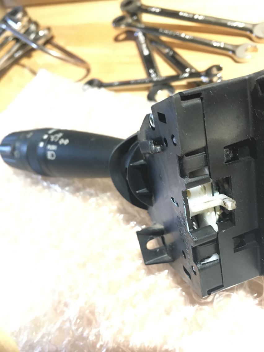

My fog lights have been going on and off especially if I move the turn signal (multi-function switch) around with my hand. My turn signal has been overly activate and deactivates itself for years but I have learned to deal with it. But now with the fogs malfunctioning I will have no choice but to fix.
Is this a Mopar only item? Rock auto has WVE brand for $54 but if this is one of those I wish I got the mopar unit please someone reply back and let me know. Im in no rush.
Wow, I'm really confused. How did we get from the turn signal switch to air bags and PCV valves? I just replaced the turn signal lever on my '07 and it'll take you 15-20 minutes to figure out how to remove the steering wheel shroud, and 2-3 to actually do it. Give it 5 minutes to replace the multifunction switch. Another 5 to reassemble the shroud. You're done. No air bag. No PCV valve. It fixed my weird dash lighting problem where they wouldn't dim properly, and the interior dome light would turn on at the wrong switch positions. But, the switch, bought from AutoZone, cost me about $90 (with military discount). Every other switch I found online was in the low one hundred dollar price range.

Ha ha thanks Mark for the info. Yea I got all over the place with this one I didn't want to post 3 different topics for a few small little things. The multi function switch just came in. It was on Rock Auto for $55 but let me know if this isn't going to work and I'll return it and get the one you have that we know is currently working.

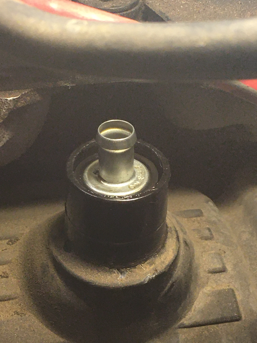

I'll let you know how the switch works. Seems to be pretty generic. As for the PCV Valve if you watch the video mine is just kinda hanging out on top. It came out extremely easy. Im wondering if it was even put in right when the dealer did it for free like 7 years ago.
Does anyone know what size socket they used to tap it down?

Ok so I reinstalled the PCV valve and it definitely sits down slightly inside now. Glad I got that fixed. Also did the multifunction switch and that solved all of my fog and turn signal issues.
