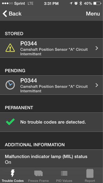

this is what is being read

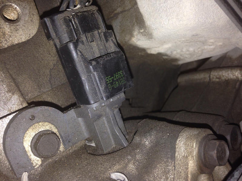

Never mind about the pics I went looking tonight for it found it I already ordered the part could it be that the original one just needs to be cleaned then reinstalled?

Confirmation
