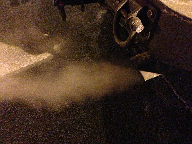

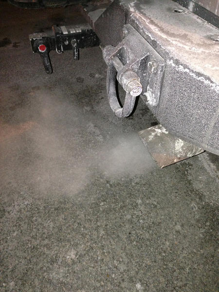

Also, this is what I'm getting after a cold start.

The dealership just called back and confirmed the cylinder 4 misfire. They are going to change the spark plugs, update some computer module, and reset the CEL for $212. As far as the loss of oil, they recommended a carbon flush at the time of my next oil change. They also said my PCV valve was fine.

Alrighty, so got my Jeep back from the dealer and everything seems fine. It's been a couple of days and so far there has been no sign of a returning CEL. The dealership only changed the spark plugs and updated the PCM.
However, I am noticing a slight tremble just before I come to a stop, when the RPM's are at their lowest. It idle's perfectly though, no roughness. I can't remember it doing that before. Any thoughts would be greatly appreciated.
