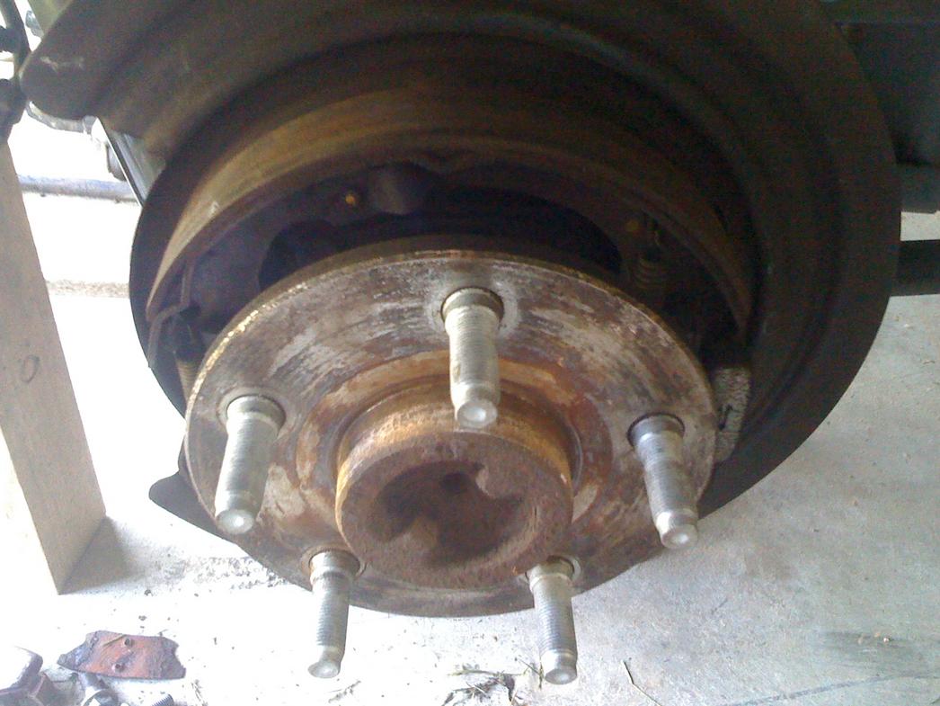

Question
Hey JK, you mind snapping a couple of pics while you're in there? I'm sure there's a couple of us that are curious as to what it looks like inside.

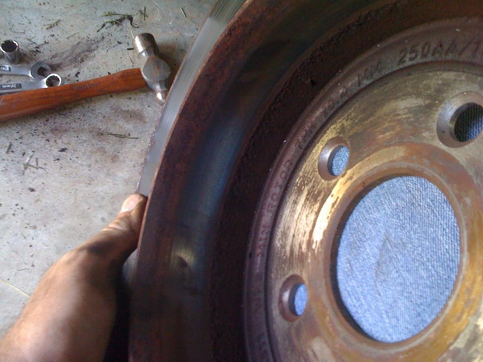

Question .... we have seperate pads for the ebrake as opposed to them activating the regular pad? where are these pads at? I have seen brakes between the driveline tranny on big truck but I know we dont have that.
If this is true then it make sense why when I forgot my ebrake on that I got a 1/2 a block before i noticed it. Mine has hold on inclines but none against the engine.
They are on the inside of the rotor. The rotor is both a rotor and a drum. If you take the rotor off you will see the drum brake set up that is the e-brake.

Old Aug 30, 2010 | 02:17 AM
Jedi Knight's Avatar
Posts: 366
From: Westminster, MD
Here ya go:
Parking Brake Shoes:
Drum in rotor:
I pick up the shoes tonight. I'll see if I can figure it out.
