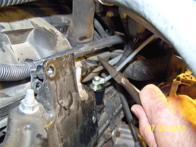

Have a look at this thread by ronjenx; it explains what the PCV valve does and has cut-away pics of the internals:
https://www.jk-forum.com/forums/show...cv+valve+study
And take a look at this thread (also by ronjenx). It details all the steps (with pictures) involved in accessing and removing the valve including a quick and easy way method to remove the PCV valve undamaged using a zip tie and a pair of pliers:
