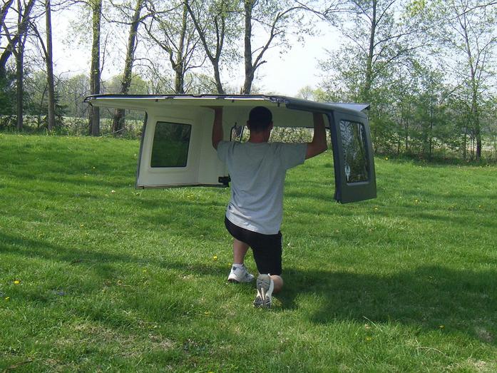

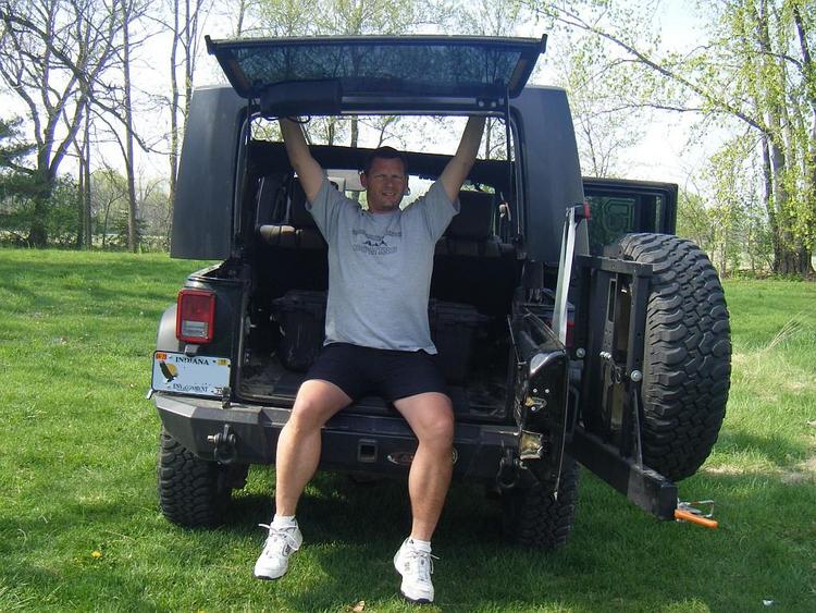

I find it MUCH easier solo.
First time was with help and the other side let it down on the gate, chipping gate paint and putting a white nick in the top. <grrr>

As for storage, it's definitely best to have something approximately Jeep high. Putting it on the ground and lifting from there is the worst part.

LOL! Looks like an exercise video. Good job!
