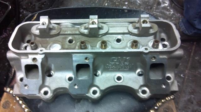

I lied, we make 3.8 heads for a company named champion out pf Florida not trickflow. Here's a pic.
