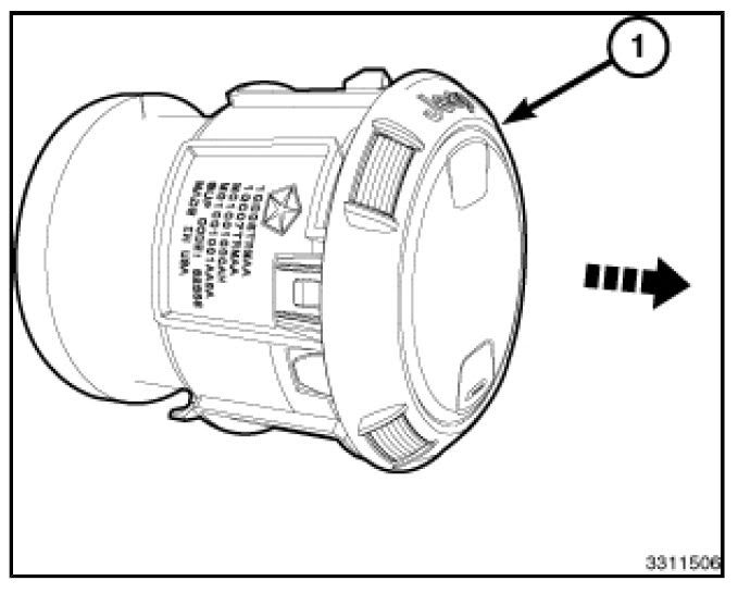

2011 JK Air Vents
I was able to graft the trim ring and the deflector onto the 07-10 outlet casing HERE
Part Numbers:
1QC05DX9AD: Outlet, Base Interior Accents
1QC07DX9AD: Outlet, Bright Interior Accents

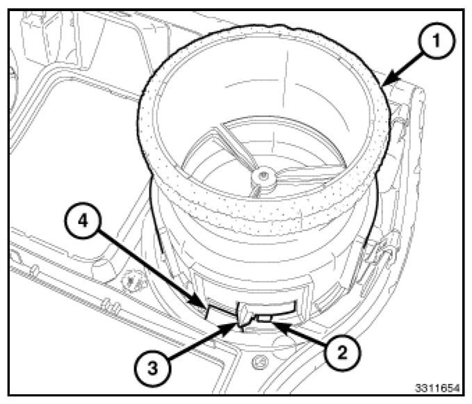

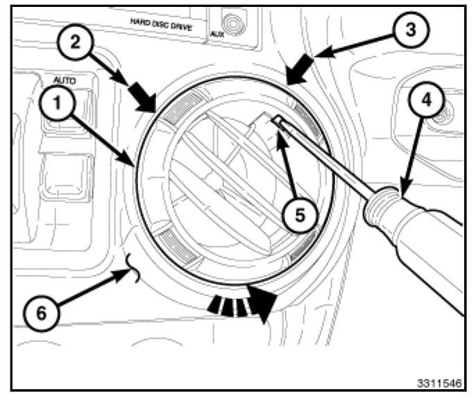

Removal:
1. Each air outlet (1) is secured by a retaining tab (3) located on the outlet, and a stop tab (4) located on the back of the trim panel. Access the retaining tab from the inside of the air outlet, through the square openings (2) provided.
2. Rotate the louvers of the air outlet (1) being serviced to the eleven-oclock position (2).
3. Place a small screwdriver (4) or equivalent through the square opening (5) inside of the air outlet, located at the twelve-thirty position (3).
4. Carefully pry the retaining tab (shown in previous illustration) toward the center of the air outlet and rotate the outlet counterclockwise.
