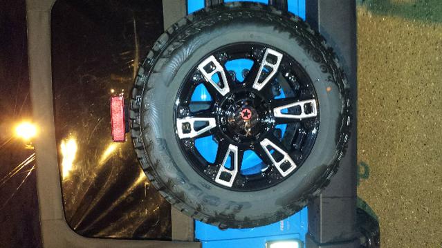

So I am looking for ideas on what can work to protect my rims for the winter the gloss finish on them may not fare too well against the snow and salt of the city. Does anybody have any ideas on what I can place on them to protect them from the salt besides plasti dipping them?

If one is that particular (I would be if I had those rims also) is to get second set of a winter tires with off road/winter rims.. (4 for the road, tire cover for the spare) and place the good set in storage till next spring.

During winter I wipe down my gloss black rims with wd40.

FLUID FILM... End discussion.
WD is solvent based and will fade paint. Fluid film is safe for almost everything, yes ... It will attract shit but easily cleans off. Reapply as needed.
Smells good too. http://www.fluid-film.com/
I bought a can at Napa. Everything I use it on is rust free. Awesome stuff.
Edit: in case anybody's wondering. Fluid film will not spin off that easily. I coated the slip joint of my axle shaft. It's still coated since spring.
