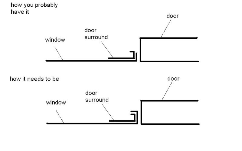

Thanks for the tips on the doors guys, but what I really need to know is how to keep the side windows of the soft top from flapping around when i have my doors on. Anybody have any tips?
My guess is you aren't tucking the leading edge if the soft window into the channel of the door surround.
See post 18:
http://www.wranglerforum.com/f274/so...ds-163181.html

Here's an image I saved from a post a while ago. I can't recall who drew it or I'd credit him...
