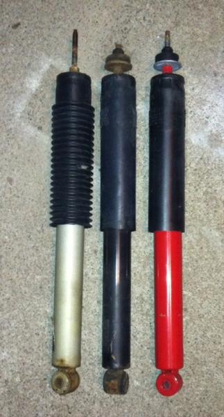

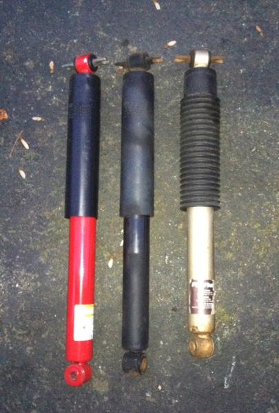

We all like pictures, right?
Rubicon vs Sahara vs Monroe Reflex Monotubes.
The rear Monroes are obviously very short. After I bought them, they released 1 or two more models that are longer.

Old Oct 11, 2013 | 07:09 AM
Kojack's Avatar
Posts: 3,213
Likes: 21
Mine reflex shocks are longer as they were made for the rubi. I measured both.
Old Oct 11, 2013 | 07:12 AM
yo_marc's Avatar
Joined: Jun 2008
Posts: 1,071
From: Attleboro, MA
I swear they became available a week after I got mine
How do you like yours? Are the holding up well?
I think mine [in the pictures] have right around 50K miles on them.
