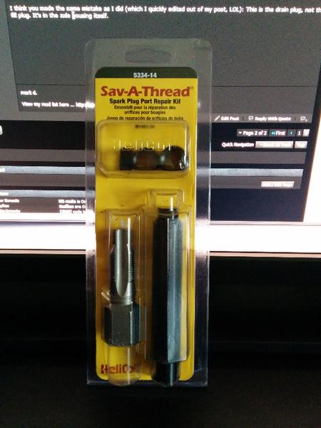

There are also repair kits such as the that can restore large thread sizes.
