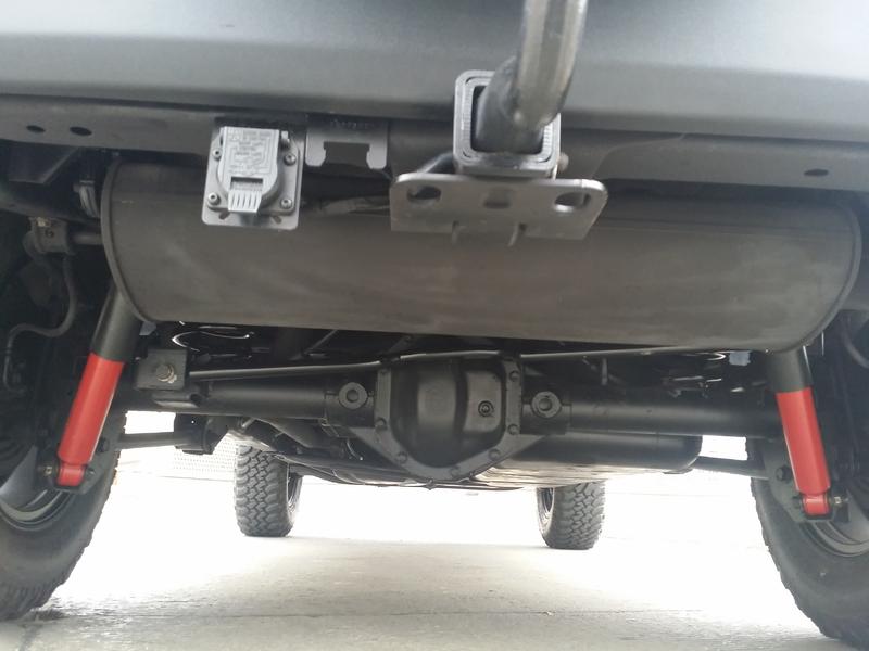

Well, I saw this thread and I guess you can say this is my #1 pet peeve.
Here is what I have done for surface rust under my '11 JKU...the dealer even was shocked on how nice the under body came out:
1) Wire brush or sandpaper any heavy spots of rust, then hit them and frame rails with breakeCleen (I like the CRC Red Brand)
2) Go to Home Depot or Kmart and buy at least 5-8 cans of Rust Oleum Rust Refromer in satin black : Auto Paint Chemicals Rust Reformer Spray Product Page
3) Basically drench the entire underbody, 2 heavy coats then let dry
4) Order 3 cans (this is enough IMO) of Eastwood internal frame treatment in black...rust proof the frame from the inside out, this stuff works : http://www.eastwood.com/internal-fra...lack-14oz.html
5) As a final top coat, I painted anything metal minus the exhaust in VHT Rollbar and Chasis Semi-Gloss (3 medium coats, 6 cans) : VHT Roll Bar & Chassis Paint
6) For the header downtubes, exhaust and rear muffler I did 2 coasts when warmed up of VHT Satin High Temp: VHT FlameProof? Coating
....now your as rust proofed as I would know how (did a lot of testing and research)
Here is shot of my JKU underside:

wow, jeepjk4 that looks great and thanks for the links in the different products you used.
How long have you had it undercoated like that? how has it held up?
i live in nj and i have tried multiple methods of undercoating including professional undercoating. Nothing seems to last longer than about 3 years without getting rust underneath it, etc... most recently i have been using fluid film once a year and it seems to help, but i might try the method you used.
