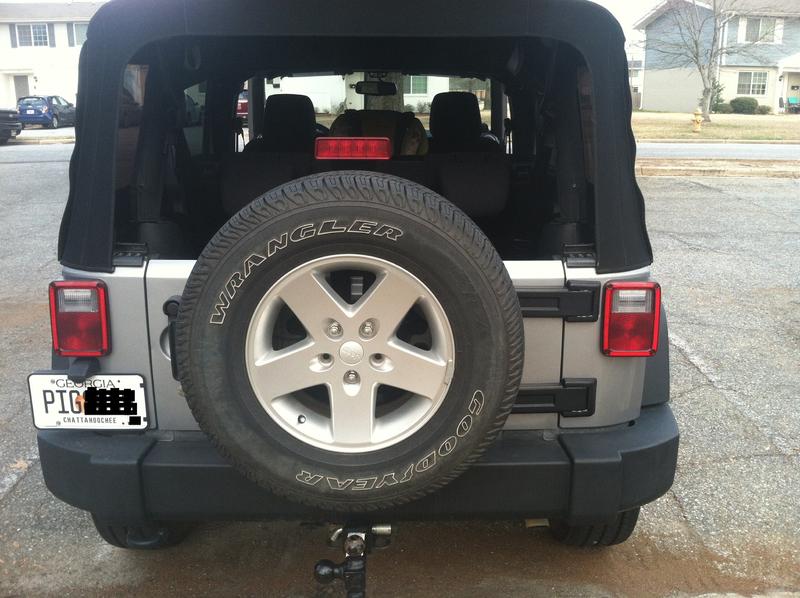

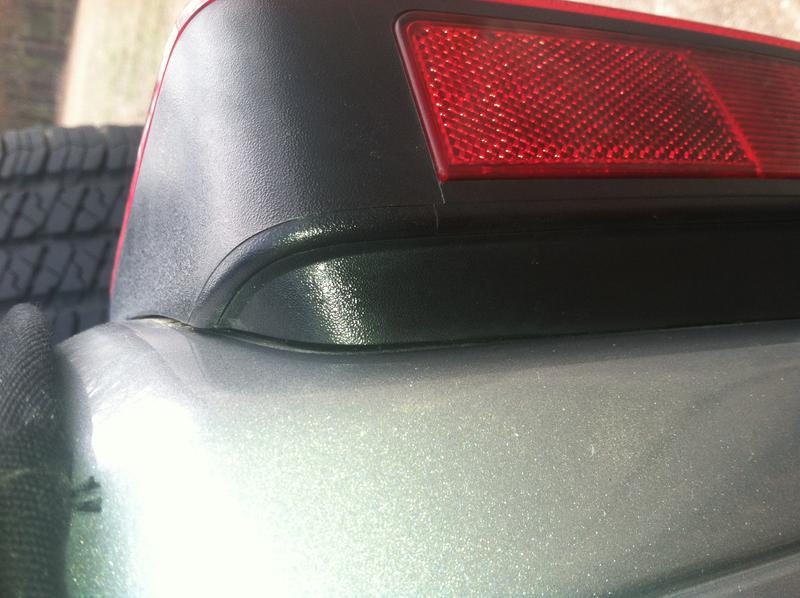

I flipped the tail light housings to place the reverse light on top of the brake light to have a free / 2 minute mod today. Only problem I have with it is that the housings no longer sit flush with the body. I may just add some weather proofing strips to fill the hole. Has anyone found a different solution.Click image for larger version

The tail light is actually 3 pieces. You can probably pull the lens, then pull the housing away from shim. The shim screws are on the outside and the ones that bolt them to the body are on the inside (closest to the tailgate).
The only thing doing the tail light flip does is make it look more 'retro' like the TJ, YJ, CJ, etc.
