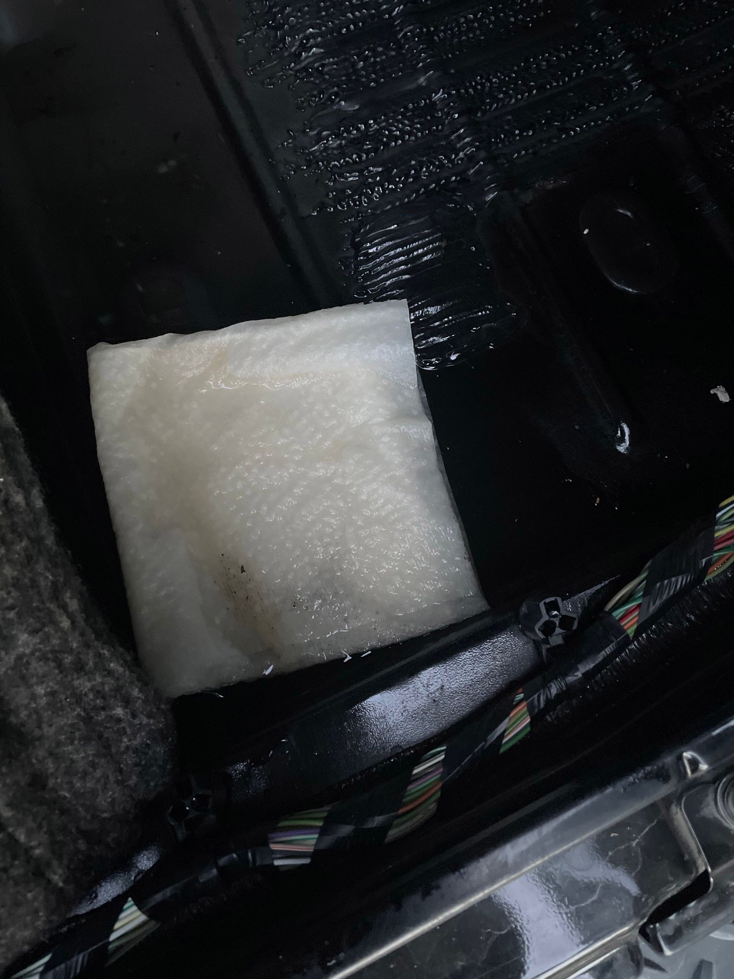

So I got impatient and pulled the carpet back and there was a puddle, the carpet pad was orangeish but I didn't see any rust. but the puddle looked clear when I put a paper towel down. So I feel like I'm back to not knowing lol, the coolant I put in was orange/ yellow. It has 118k mi on it so theres a chance theres been a coolant flush or two. So no clue, it has a diagnostic appointment next week because I've already replaced one heater core recently on my classic mustang and once is more than enough for me.
pad under the carpet
floor pan
paper towel in the puddle
