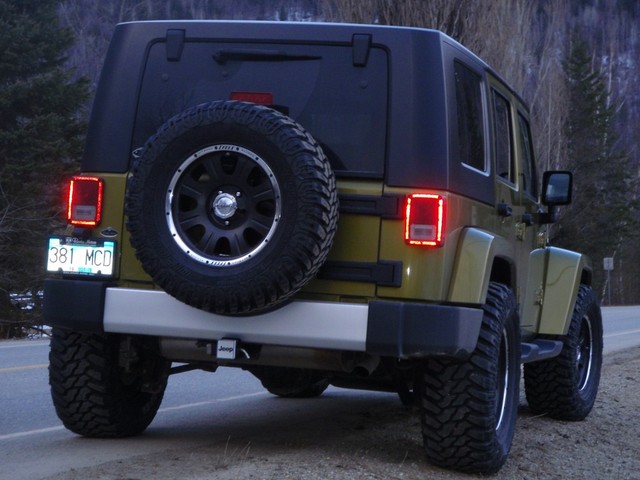

Not sure if that helps or not, but basically the LESS backspacing you have then the further your tire/wheel will stick out...the MORE backspacing, the further it will sit in closer to the frame.
For example, the wheels I used to have on my JK were 16x8 with 4" backspacing and I didn't like how they were sticking out past the fender....so I bought some 16x8 with 5" backspacing and now they sit just under the fender where I want instead of sticking out.
Also, any 2"-2.5" budget boost or coil kit would be perfect for running 33's...but you don't HAVE to have a lift to run 33's, it just looks better and will perform better off-road obviously.
Here is mine....2.5" Rough Country Coil kit and 33x11.50x16 tires on Cragar Soft 8's with 5" backspacing:

Here's a couple pics I found....you can get an idea of what a difference just wheels and tires can make..
33x11.50x16, no lift, 5" backspacing on 16x8 wheels
33x12.50x17, no lift, 4.5" backspacing on 17x8 wheels
