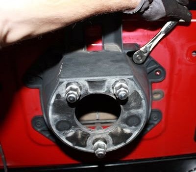

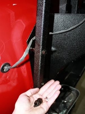

  • Use the Torx 20 driver and ratchet wrench to remove the four bolts that hold the tail light in place.
  • Disconnect the tail light wiring connector.
  • Install the 13mm socket on your ratchet wrench, and remove the eight bolts holding the tire carrier in place.
  • Figure 2. Remove tail light and disconnect wiring.
  • Figure 3. Undo tire carrier bolts.
  • Figure 4. It doesn't hurt to clean this area while at it.

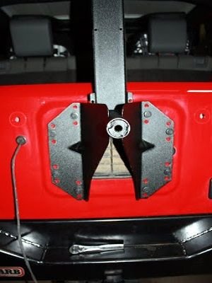

  • Mount the Smittybilt tire carrier on your tailgate using the appropriate holes. Keep in mind you will only use four bolts instead of the original eight.
  • Use the 13mm socket and ratchet wrench to tighten down the bolts properly.

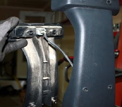

  • Attach the stock tail light to the new Smittybilt tail light bracket included with the tire carrier.
  • Plug in the tail light wiring connector.

  • Figure 6. Bolt Smittybilt tire carrier.
  • Figure 7. Attach stock tail light to bracket.
