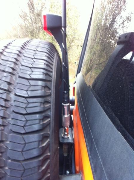

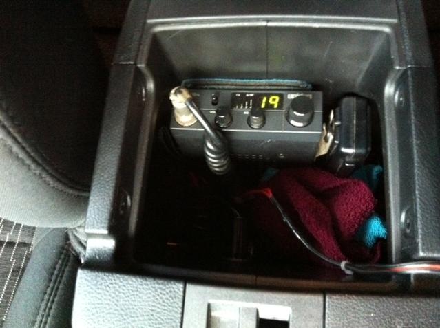

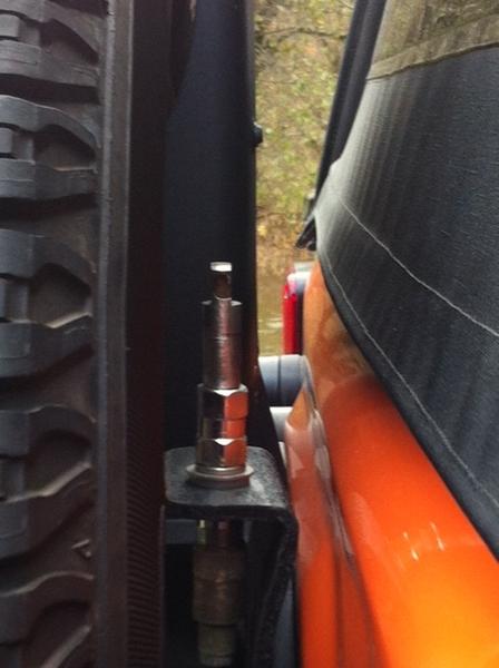

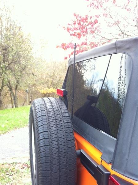

I installed the CB and Antenna this past week. I located the CB in the center console and ran the power cord up through the bottom. I used a 2 foot antenna and mounted the antenna on the rear. It barely comes above the roof. I also used a quick disconnect so it can be removed easy if necessary. I figured no more than I will use it, that inside the console will work fine for me.
I did the same install today, love it!
