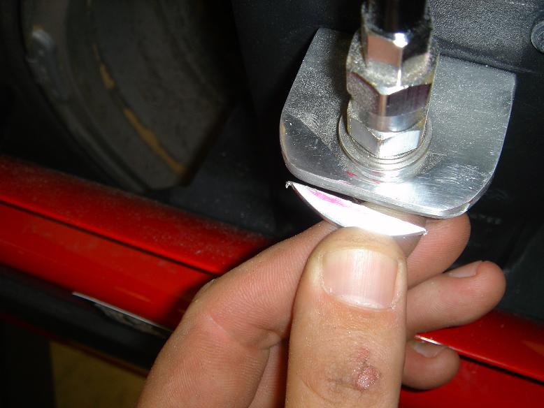

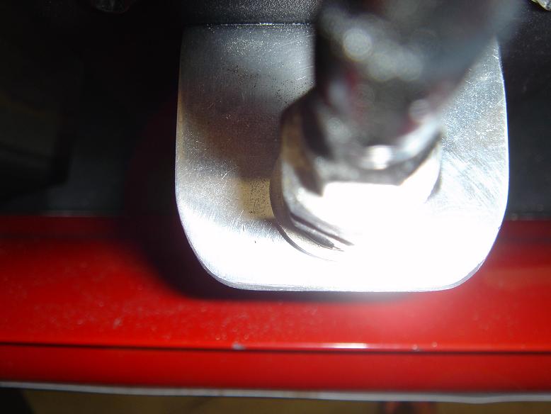

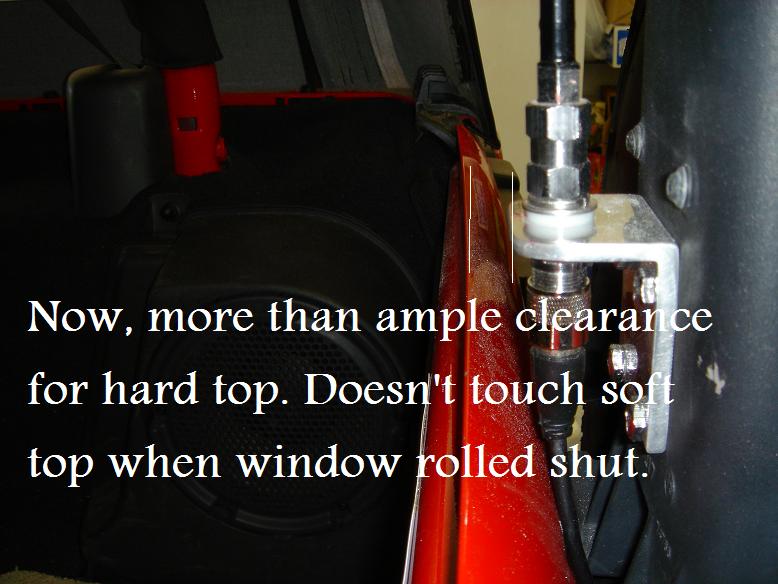

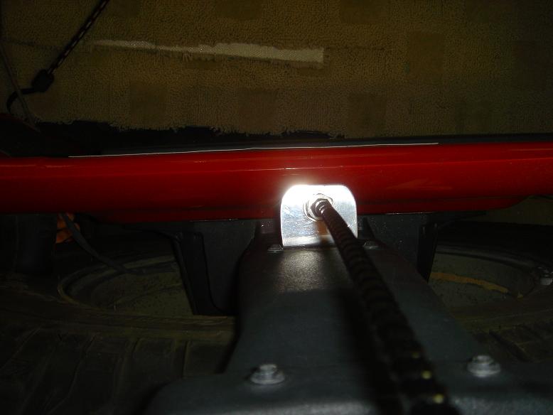

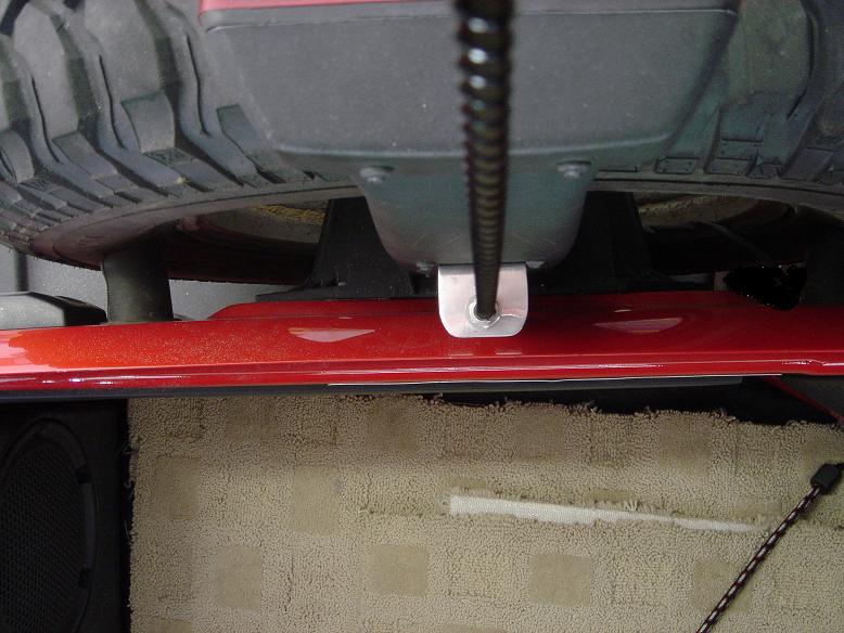

Good info, Just to give more clearance if I install the hardtop I removed some metal. Now it doesn't even contact the softtop rear window. I opened and slammed the rear door and it moves/flex more than an 8th" but less than 1/4", but just in case.
