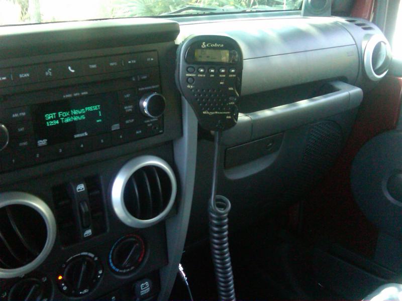

Went the Cobra 75 route for my 2010 JKUS after months of research. Had it for over a year now. Use it often on the interstates where I get 5 mile range. I would not consider "upgrading" or switching to any other CB. It does everything I need and more.
I went with the CoolTechLLC kit:
- Cobra 75 WXST. (scans and includes weather radio)
- VersaMount mic hook that mounts on radio screws behind trim (no cutting or drilling).
- GateMount antenna bracket. (includes longer tire mount screws)
- 4' FireStik FL-4 FireFly antenna. (very flexible)
- 18' coax with FireRing connector on antenna side and mini-UHF on radio side with mini-UHF to PL-259 adapter. (Easy routing, No Soldering)
- all required hardware (stainless screws, bolts, washers, etc.)
First pic is view from driver's seat. Indicators visable, speaker pointed at you, in easy reach.

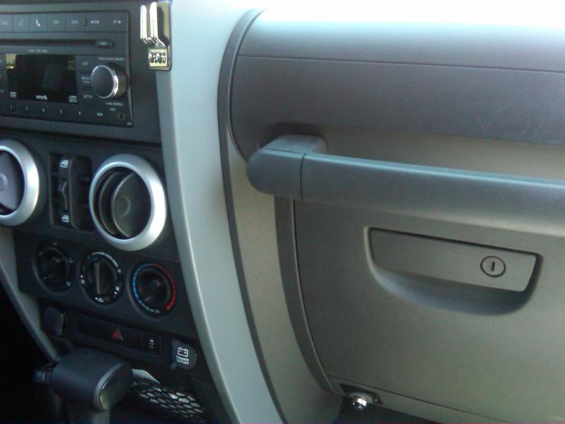

2nd pic shouws antenna. I inverted the GateMount so I could use a 4' and still get in the garage with minimal bump.
3rd pic is what passenger sees when radio is stored in the center console.

Second this. The CB connects into a canon plug you can drill through the bottom of the dash. I chose to and leave the plug accessible from under the dash. When the CB is unplugged, no one even knows it's there. No sweat with the doors off.
