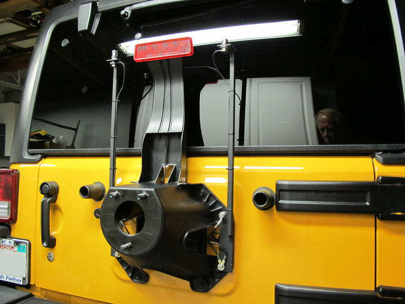

I used 2 Arizona Rocky Road mounts for my ham and cb antennas. He drilled the mounts specifically for the ham and cb antennas. Works OK, not quite 24" separation though.
Attachment 640013
That works as ling as you use a no-ground plane antenna for the ham antenna.
My antenna is a Diamond HA770HAB. The mount is grounded to the body.
I don't see anything on the packaging that says no-ground plane. Is it? How would I find out?

I think the no-ground plane antennas usually have masts out to the side in a + pattern or a big cylinder around the base.
