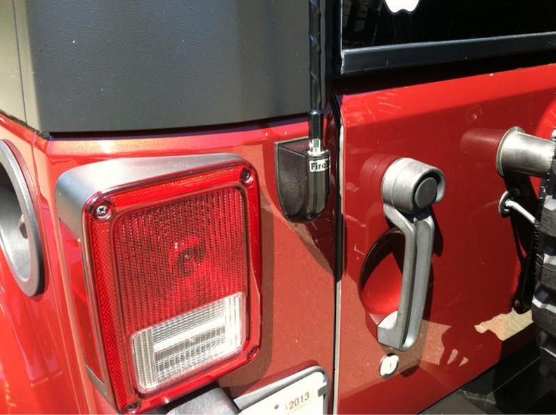

I went with GP set up using a 3' Firestik Firefly antenna. Had to do a little internal tub trim for this location. My SWR is 1.2 across all channels.
Old Apr 15, 2013 | 12:02 PM
  #193
Cobb_Sahara's Avatar
Posts: 377
From: Lawrenceville, Ga
Originally Posted by BlackRockBurner
<img src="https://www.jk-forum.com/forums/attachment.php?attachmentid=447094"/>
That looks great. Do you have any pictures during the install?

Old May 7, 2013 | 03:58 PM
  #196
mikeronie's Avatar
Posts: 6
From: Riverside, California
Attachment 447094
I like the looks of this mount however it will not work on a 2012. The rear window is wider than the tail gate door.
Mike
Old May 7, 2013 | 05:47 PM
  #197
BlackRockBurner's Avatar
Posts: 1,186
From: Vallejo, CA
Mike
The M2 mount location can move closer towards the taillight, allowing more room for the window to clear the antenna. Not sure if it's enough to clear though.
Old May 8, 2013 | 09:01 AM
  #198
mikeronie's Avatar
Posts: 6
If you run a strait edge from the rear window down to the level of the tail light there is about 1/2" space, close to the same as a fire stick antenna. I don't know what year the window size changed.
Mike
Old May 8, 2013 | 07:11 PM
  #199
zstairlessone's Avatar
Joined: Dec 2009
Posts: 1,695
From: Texas
Mike
I think '11 was the change
Old May 8, 2013 | 09:27 PM
  #200
Posts: 1,186
From: Vallejo, CA
Mike
Firestik makes a folding adaptor. Fold the antenna down to clear the hatch glass, then bring the antenna up.
