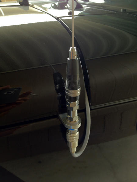

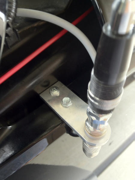

After reading this thread and talking to the cb shop here is what I ended up with. Got it all mounted and wired now just need to find an open area to tune it.
Antenna mount came with a lower bracket to mount to big rig mirror not used, then I cut the length off just past the first hole and drilled another. Searched forever to find a way to go thru to the cab with the cable since it won't fit through the holes filled with the spray expandable foam. Found this nice spot I never new was there inside cab it's covered with black sticky tape and the engine compartment side is black rubber with a cross cut on it already. Figured this would be great since it wouldn't be running right along with my amp power line for the sub. The small red wire you see is for the led lights which will get covered with wire loom. The antenna is tunable if you look close you can see the two metal ring that turn and lock at the base of the antenna. And it's nice and thin as to not obstruct the view too much.

Ok went last night to an open area to tune it. As it sat without any adjustments the swr meter was showing 1.5 on 1, 1.4 on 20, and 1.5 on 40, I tuned it and best I could get out of it is 1.3,1.2,1.3 respectively. I don't think I could get much better than that.
