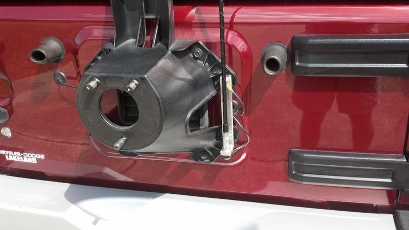

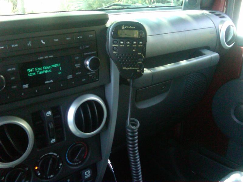

4' FireStik on CoolTechLLC Gate Mount. Inverted for garage door clearance. (Note separate ground wire on top bolt to subwoofer acorn nut.) Been working fantastic with my Cobra 75 for the past year.

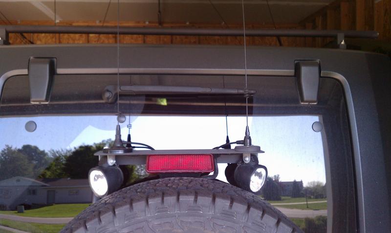

So what are your honest opinions of my setup?
Attachment 314393
The left antenna is a 2m/70cm ham antenna and the right one is for a handheld cb. The steel plate is 17" wide and the antennas are at least 12" apart.
I went with magnetic antennas for ease of swapping them between large ones for trails and travelling and short ones for everyday use that fit in the garage.
SWR meter reading are 1.2 and 1.3.
I ran the two coax cables through the tailgate (left an 8in loop at the hinge inside for flexing) out through a grommet behind the spare to a QD connector. This way I can open the tailgate, reach down in the spare tire and unscrew the connector, swap antennas, or leave them off.
Trail performance has just fine. I love having them back there out of the way of branches. I also like the height.
Honestly the only time I use the CB is with other Jeeps on the trails. I don't know anyone else that even owns them.
My mobile ham radio I use more often and haven't had issues with it. I can run simplex with others or hit the local repeaters with no problem.
Thanks for any constructive criticism!
The fact that your have mounted a nice chunk of steel there is great. Also great is in your case the magnets are probably providing much better grounding that traditional antenna mounts. I have found that the magnetic bases can perform better in certain circumstances. Your low SWR would seem to confirm that. I’m not a fan of tailgate mounts just because of the back window not being able to be open with the antennas there, but that is personal preference. In your case you have come up with a good balance of convenience and performance. You could get even better performance with this setup with longer antennas but if there talking the distance you need than great.
