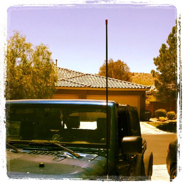

Can we see some of these cowl mounts including pictures of the jeep from a distance with the type of antenna used. I would like to see what antennas people are mounting up front and what the jeeps look like!
From instagram
