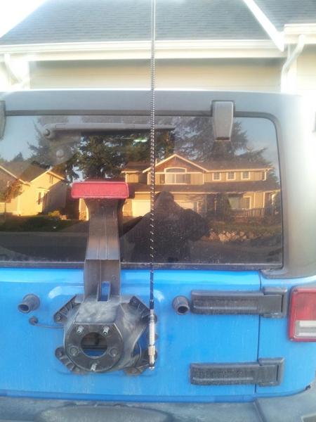

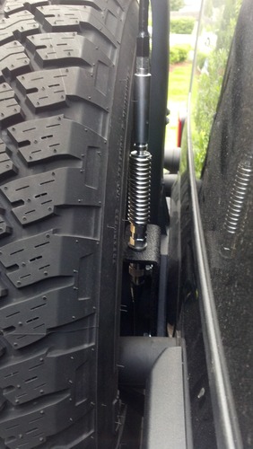

"don't put it between the tire carrier and spare tire. You wont be able to open the rear window on the hardtop with it there."
Why not?
ID:	388940   Click image for larger version
Why not?
So you can open it with it on the carrier even on the right side lol. many people keep saying the antenna blocks the rear window from opening fully

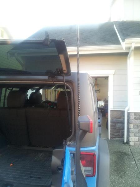

maybe they mean when the tailgate is closed you can't have the window opened..
I have two antennas on the tailgate one on the left one on the right and I can open the window just fine when the tailgate is opened....
Awesome! glad to hear it!! Thanks guys but what do you think of this setup? Any suggestions?

Originally Posted by JK-Ford
From what I understand. If you put the antenna between the tire and the back of the Jeep, it screws with the signal. I don't know how the window got involved?
People had told me that with the antenna you wont be able to open the rear window because the window would hit the antenna. Obviously that is not true with the pictures provided. Thats how it was involved.
Old Nov 16, 2012 | 06:19 AM
Sahara_Maverick's Avatar
Posts: 1,934
From: Seattle, WA
They are probably talking about you opening the window and keeping it opened without hitting the antenna if you close the gate. Meaning you will not be able to drive with the rear window opened. ;-)
