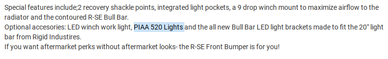

Welcome to JKF Lark. Your original post was in an old thread from 2009, and while there is nothing wrong with that, it was much less likely that people would see it and take the time to read/respond, so I moved your post to it's own new thread. I am not familiar with this bumper, but I did notice on Quadratec's listing that it noted this -
Here is a link to those lights on Amazon (look cheaper than other retailers) -
https://www.amazon.com/PIAA-5293-Cry.../dp/B000182E28
There may be some other options out there for 6" lights. For those PIAA lights specifically, it looks like they have a big wiring loom to go to the battery with a switch to trigger them. I'd bet you could splice in the factory fog wiring into that so you could trigger them off the switch on the stalk in the jeep.

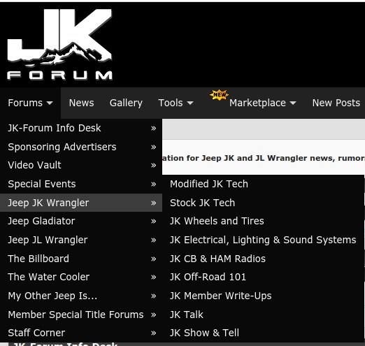

I'm usually cruising through the "new posts", but you can maneuver to the appropriate sub-forum through the banner like this -

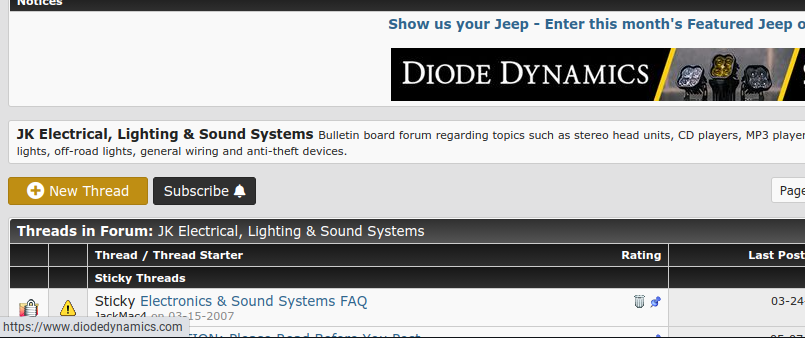

Once in a sub-forum, there is a "new thread" button at the top that you can create a thread to -

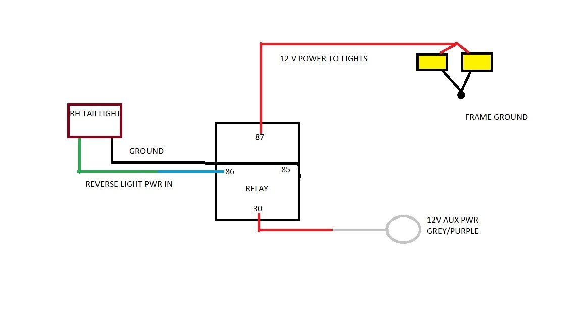

If you use a relay and only use the "power wire" from the stock driving lights as a signal wire, it would be fine. I added LED reverse lights to my hitch receiver using the reverse light "power" in the right taillight as the signal and tapping into the aux plug in back for the 12v power.
Good point.
