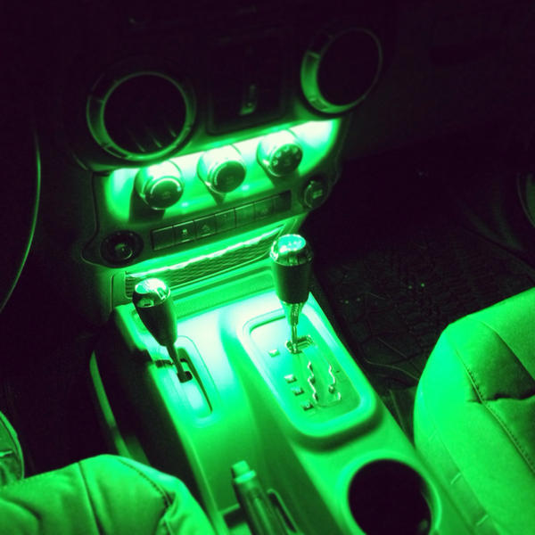

Battle mode....

Okay now I want to be a thief. How did you mount? what did you use for that and where'd ya wire that into?

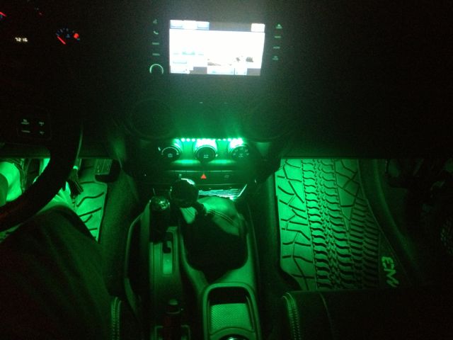

Put mine in the same place but also added to the floor....
Old Dec 24, 2013 | 01:23 AM
  #57
Arctic Blue's Avatar
Joined: Dec 2013
Posts: 202
From: madison, wisconsin
Do explain lol
Sent from my SCH-R970 using Tapatalk
Old Dec 24, 2013 | 11:30 AM
  #58
Rico's Avatar
Joined: Sep 2007
Posts: 497
From: Providence RI
Originally Posted by Arctic Blue
Do explain lol
I wired into a another wire in the passenger kick panel ...I believe it was orange with purple stripe don't quote me!... as this was a year ago but I'm sure the thread on adding led's is still in the search. I then ran them under the front dash and then drilled out a small hole in the center above the heater control knobs are and ran wire through ..attached and mine are held in place with a super 3m Black double sided tape. They've been there for a year with no signs of coming undone. I also laid a strip in front of my shifter console where the netting is. All in all pretty easy maybe a half hours worth of twisting around to get them attached but the connecting was easy. I just twisted the wires into the wire that supposedly runs from the light stalk and taped off....so they only come on when the lights come on. Sorry I don't remember the correct wire but they are all in the loom in the passenger kick. I removed the door strap to get a better reach but at 6'2" it was still a bit of contorting to get them in. I really hated how dark the cabin was and these are just enough not to be overkill. think they were 6" or 4" w 12 led's per strip really cheap. Purchased from amazon.
