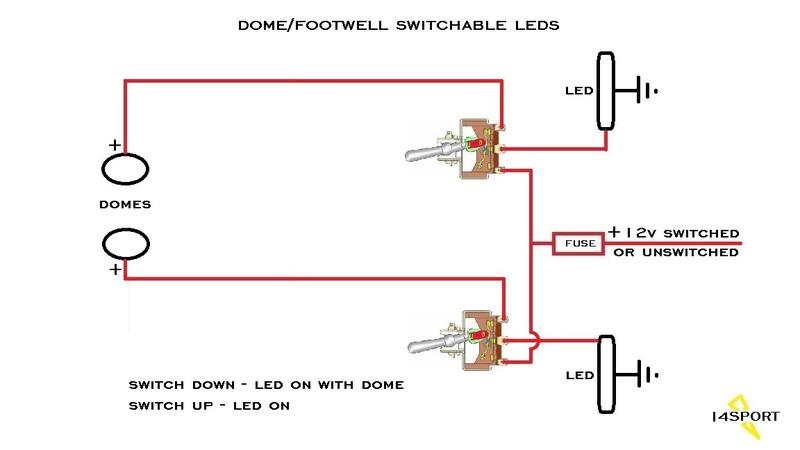

Maybe I can get some help with an idea that I have, I want to wire in an LED strip into my cargo area, I'm currently running with a security enclosure and when I'm in the back looking for something, it is dark under the the enclosure and wanted the LED to come on when the courtesy lights come on. What would I need to wire the LED strip into, which wires? Also was thinking that maybe I would install a switch to turn the strip on after the courtesy lights went out and I'm still back there doing something.
Any help for this would be greatly appreciated, I'm a novice when it comes to electrical.

Sounds like a 3 way switch would work best for you. This schematic was for footwell lights, one on each side, but you could just do one of them. The switch will allow you to either have it come on with the dome automatically, or never have it come on, or have it come on manually.
