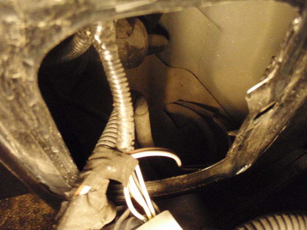

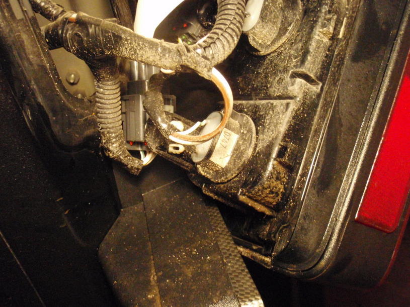

sorry it took another night, but here's the photos
Not sure if you've already figured it out on your own. However, if your hooking up your camera to only come on while reverse is engaged than you simply need to splice into the green and white wire for your power source, and the black wire for your ground....really easy to find, only two wires supplying the reverse bulb....
in my pic I use a brown and white wire (it's what I had lying around)
