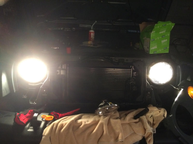

Alright, if found 7" Cibies sold by Amazon for $41.78 each, KC adapters for $19.71 for a pair, and Hella H4 60/55 for $7.69 each, & got free shipping. Going to try that set up.

Left side is Cibie 7", #082440, with Hella H4 60/55 W. Right side is stock lamp. I used a KC HiLites H13 to H4 conversion jumper, part #6307 & coated all connections with di-electric grease.
