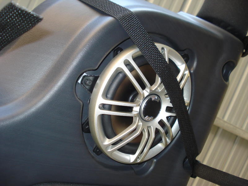

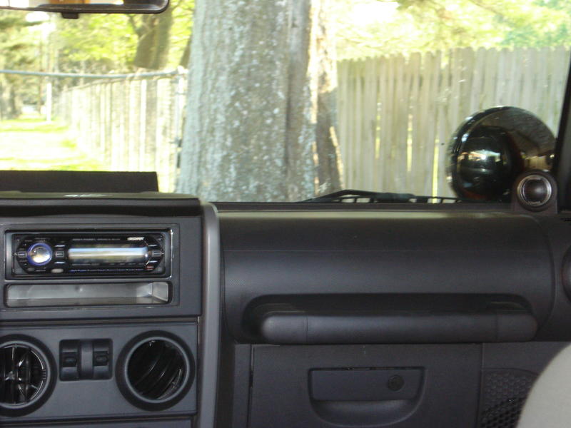

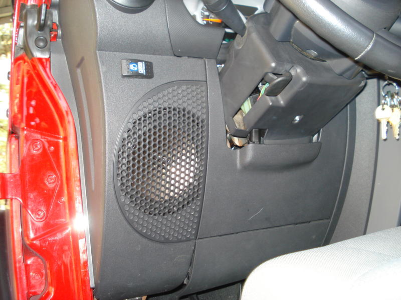

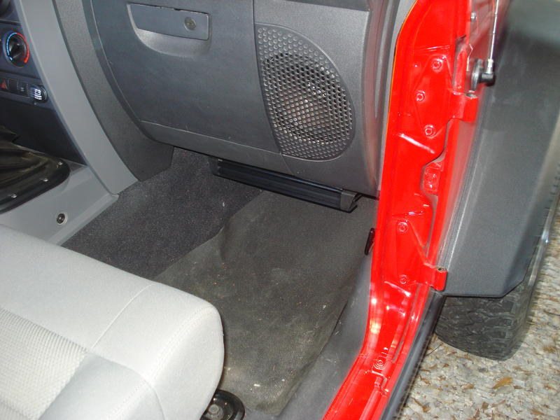

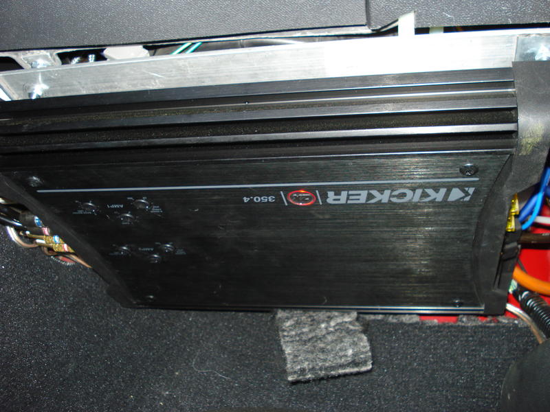

I just finished tying up all the loose ends. Completely sealed the front 2 boxes, stuffed bar speakers and sealed them, wired all 4 speakers to 2 channels, and wired subs in series bridged to other 2 channels. What can I say... this is one of the best car audio systems I’ve ever herd! No distortion at super high levels, sub thumps, and voices are crystal clear. I'm passed impressed, actually amazed. Everyone says you can't achieve this kind of sound from a jeep, they were wrong! All under a budget. Best mod so far. Will post pictures latter. Just unbelievable!

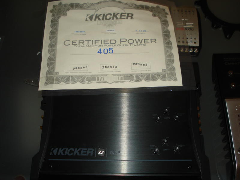

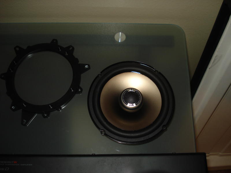

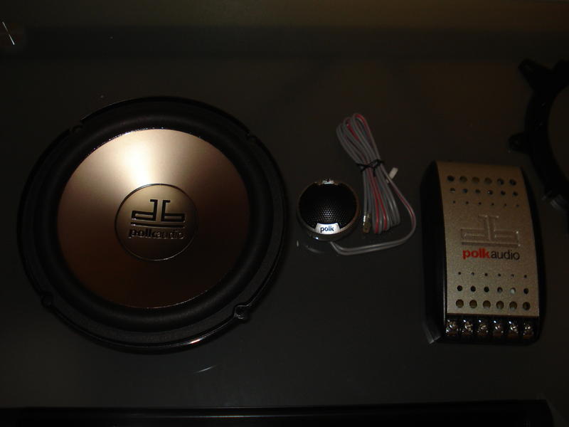

well I finally took some pictures. Sounds much better once everything is tuned in. What a difference!

did your soundbar speakers seal all the way? For some reason mine did not create a seal when using the adaptors so now I need to make a new adaptor that will seal and prevent a gap.
No it did not and don't think you fully can without major work. I even have air seeping threw the dome light.
If you are using Polk adapters supplied by Polk, assuming you purchase the db651, they work just fine but need to be sealed both sides. I purchased a bath tub seal found at home depot to use as a gasket. Has one sticky side so made working with it easy. The double gasket is a must or it will Sound like crap.
Ok thats what i thought. I may do your bathtub seal trick if that worked for you to get as best a seal as i can without going crazy.
