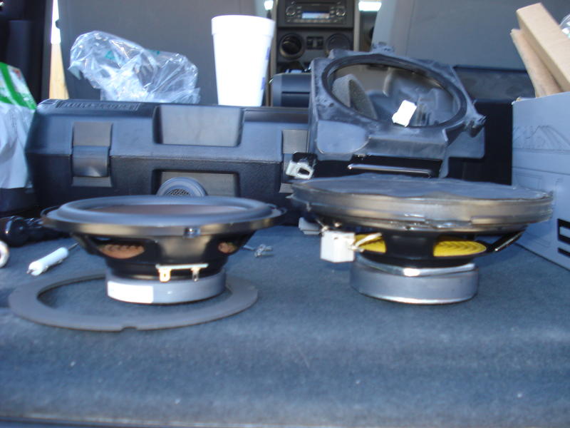

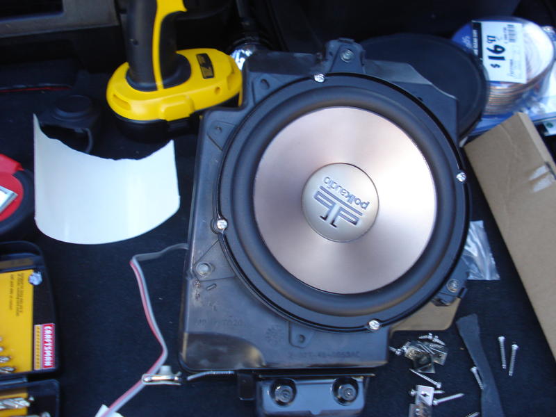

Front speakers are rattling like no ones business. Adapters supplied by polk I think are tapping against the factory plastic box. I'm ether going to hot glue, silicone, or gasket to create a seal. I inserted a peace of foam to press down factory speaker connection and create more volume. Filling the remaining void with insulated fill Friday. Polks are smaller in size compared to factory so I could see fitting larger if desired.

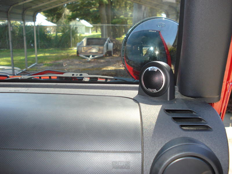

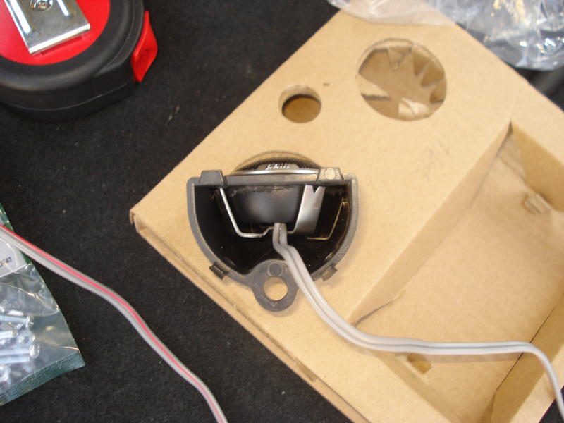

Tweeters fit perfect with some trimming and sound unbelievable. Non obtrusive and look great. Amazing clarity they added to the music.

As far as tweeters, once you remove the factory tweets you can enlarge the hole and the new tweeter will press in for a snugg fit. You can glue stick the back of it if you want to make sure they never come out.

I just finished tying up all the loose ends. Completely sealed the front 2 boxes, stuffed bar speakers and sealed them, wired all 4 speakers to 2 channels, and wired subs in series bridged to other 2 channels. What can I say... this is one of the best car audio systems I’ve ever herd! No distortion at super high levels, sub thumps, and voices are crystal clear. I'm passed impressed, actually amazed. Everyone says you can't achieve this kind of sound from a jeep, they were wrong! All under a budget. Best mod so far. Will post pictures latter. Just unbelievable!
