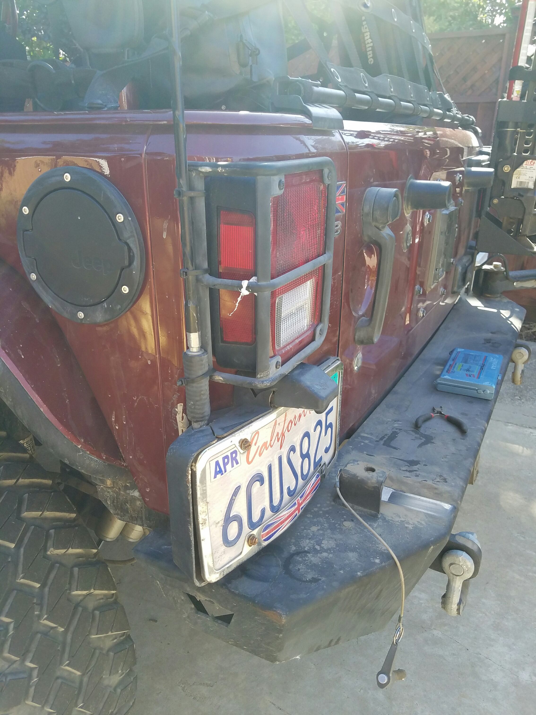

Slight incident with a tree on the Rubicon, so had to replace the rear licence plate holder. Have been looking at the AEV corner protection guards?? Still undecided.

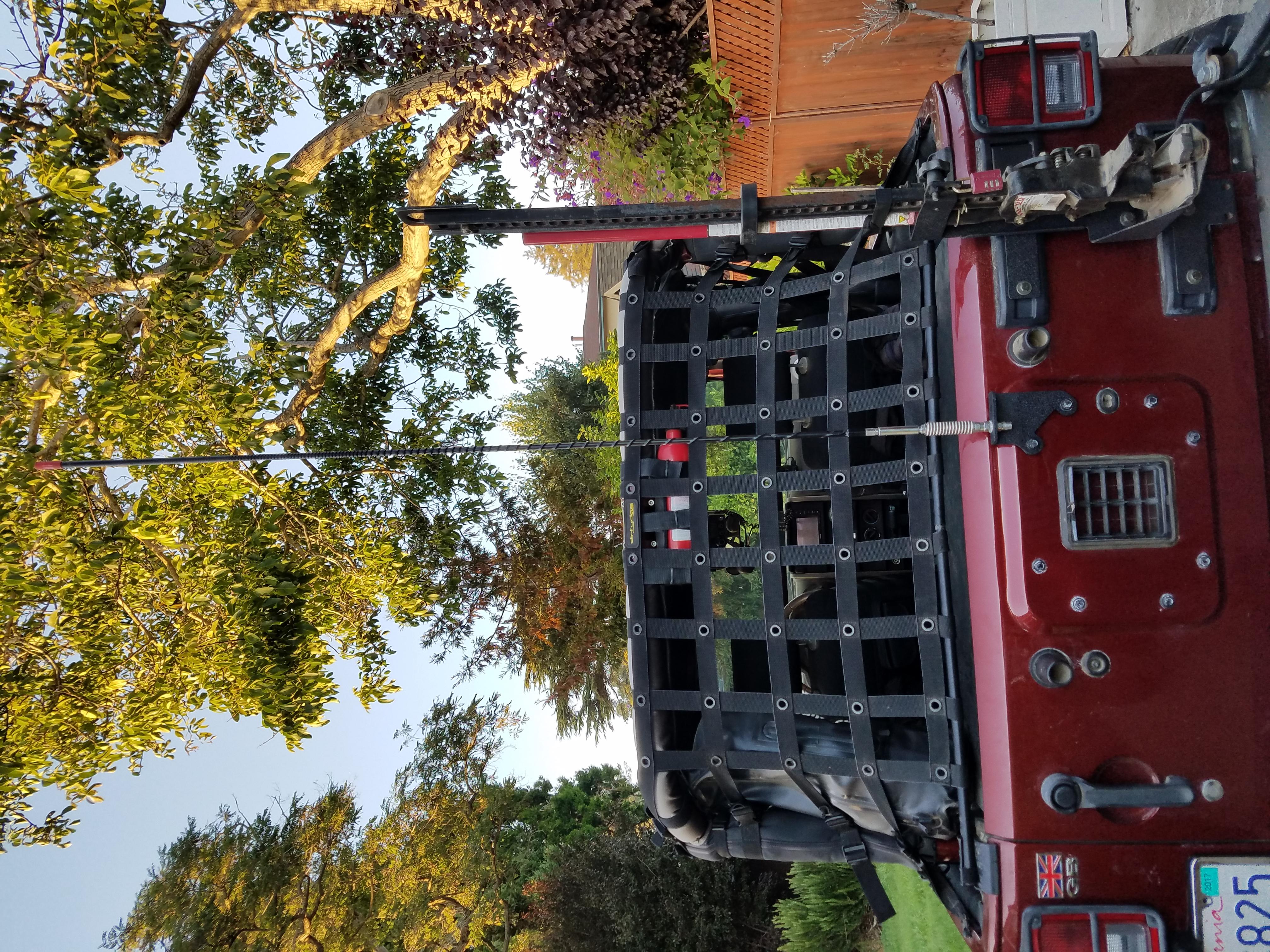

Move the CB antenna to the tailgate at the same time.

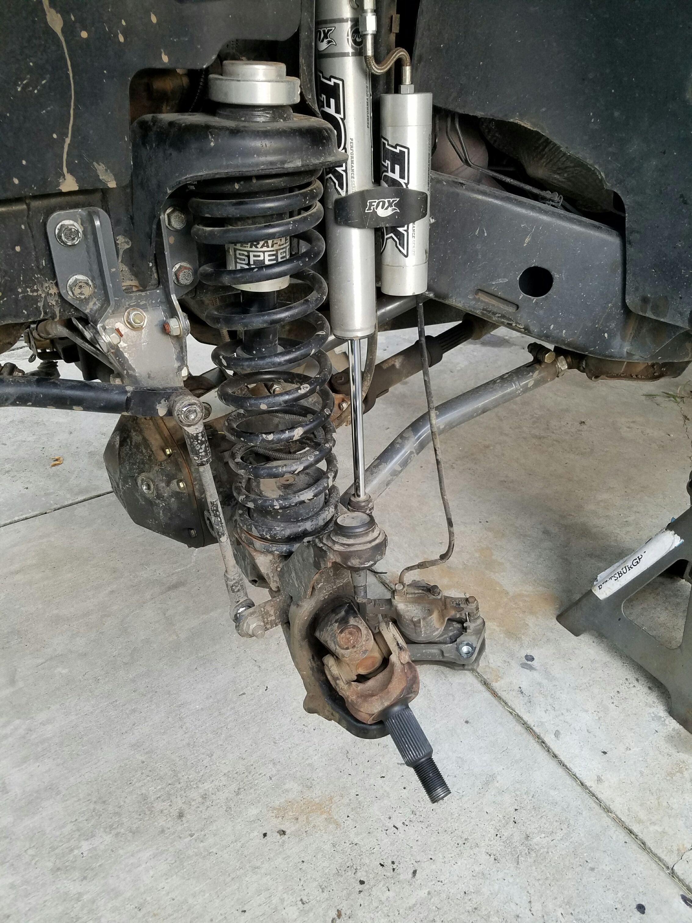

Ball joints starting to fail. passenger lower quite noticeable movement in the wheel when jacked up.

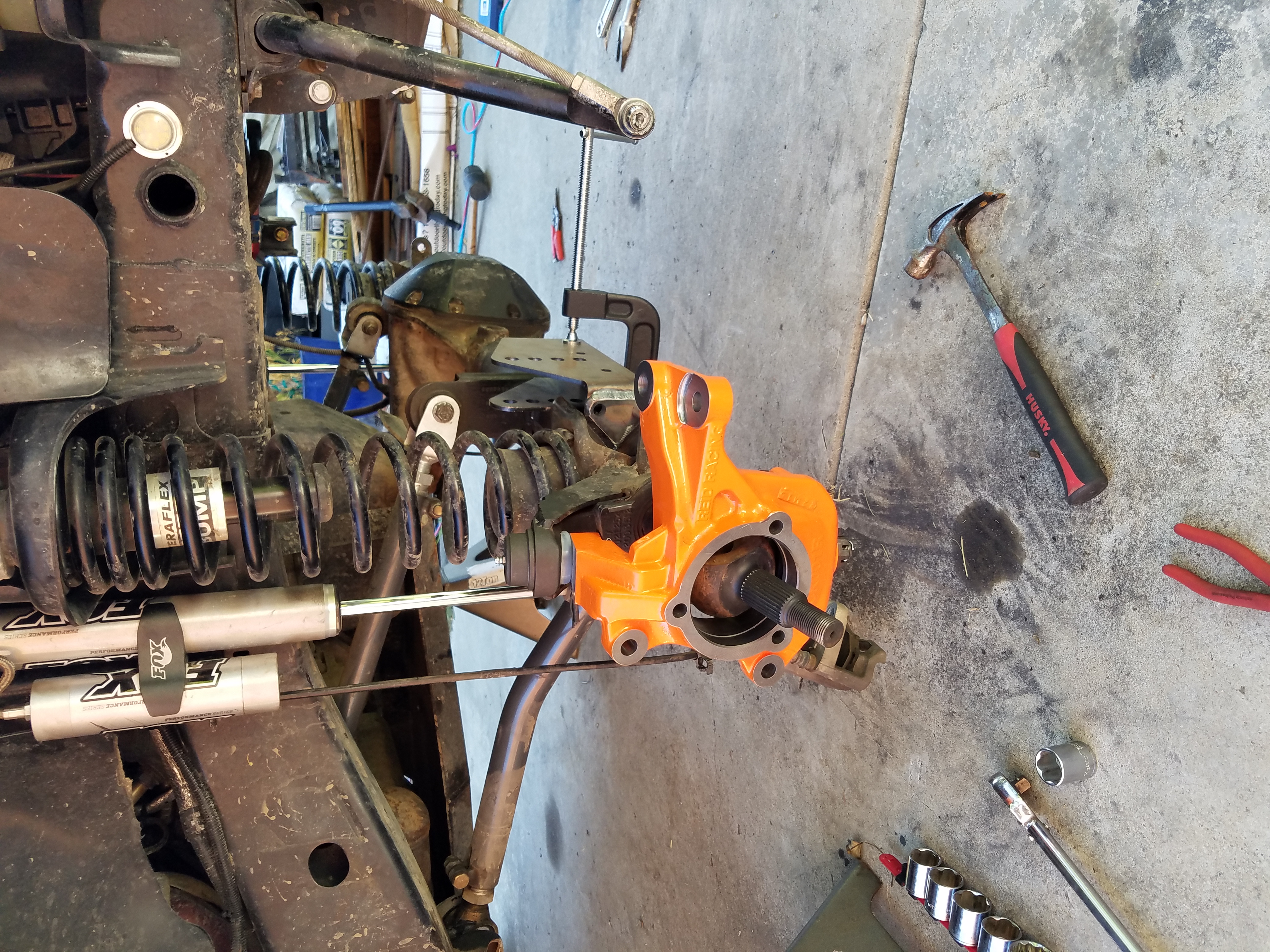

So out with the stock and in with some Synergy HDs

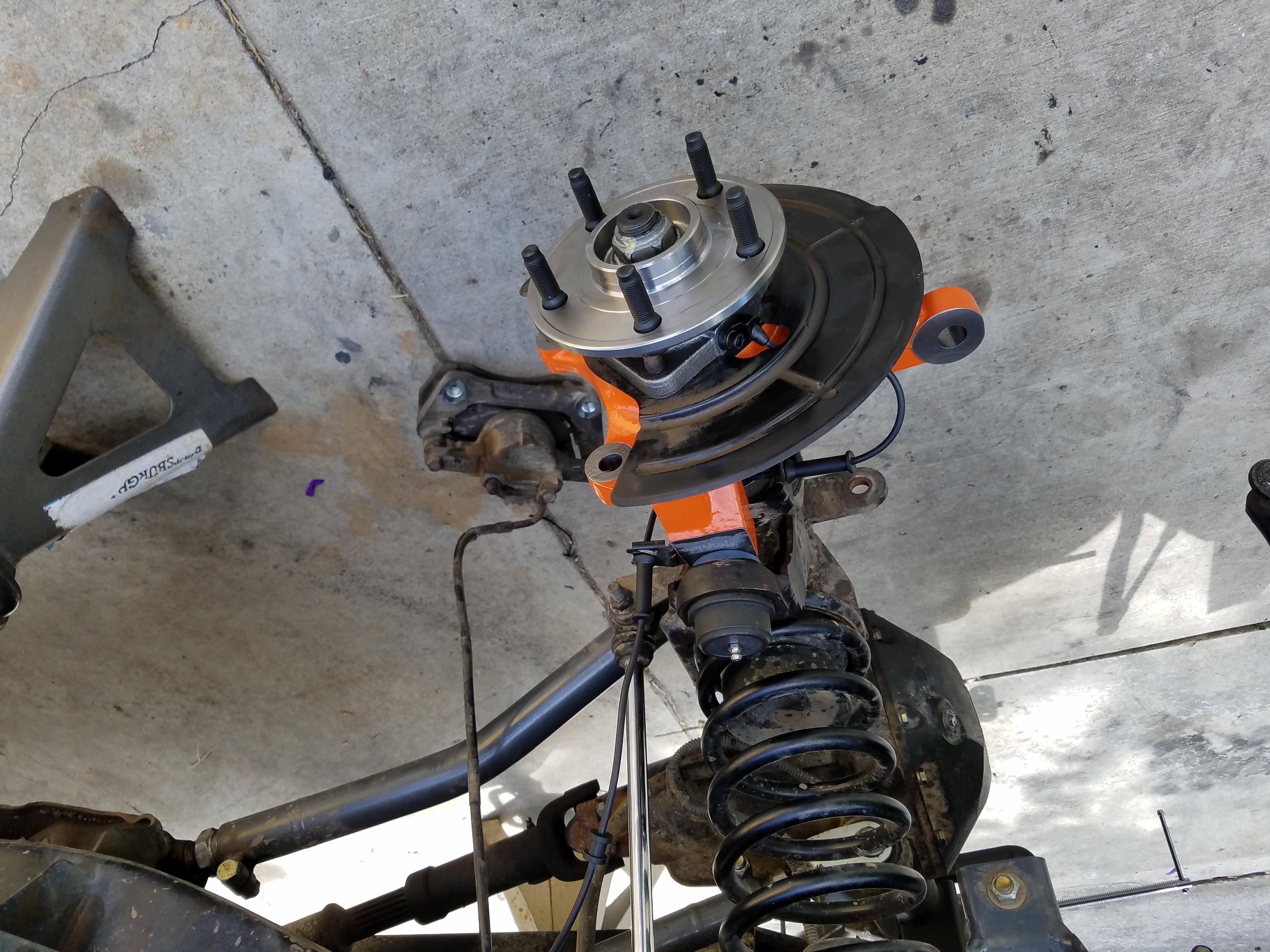

Well with new ball joints, would be rude not to throw on some Reid Racing knuckles and unit bearings also.

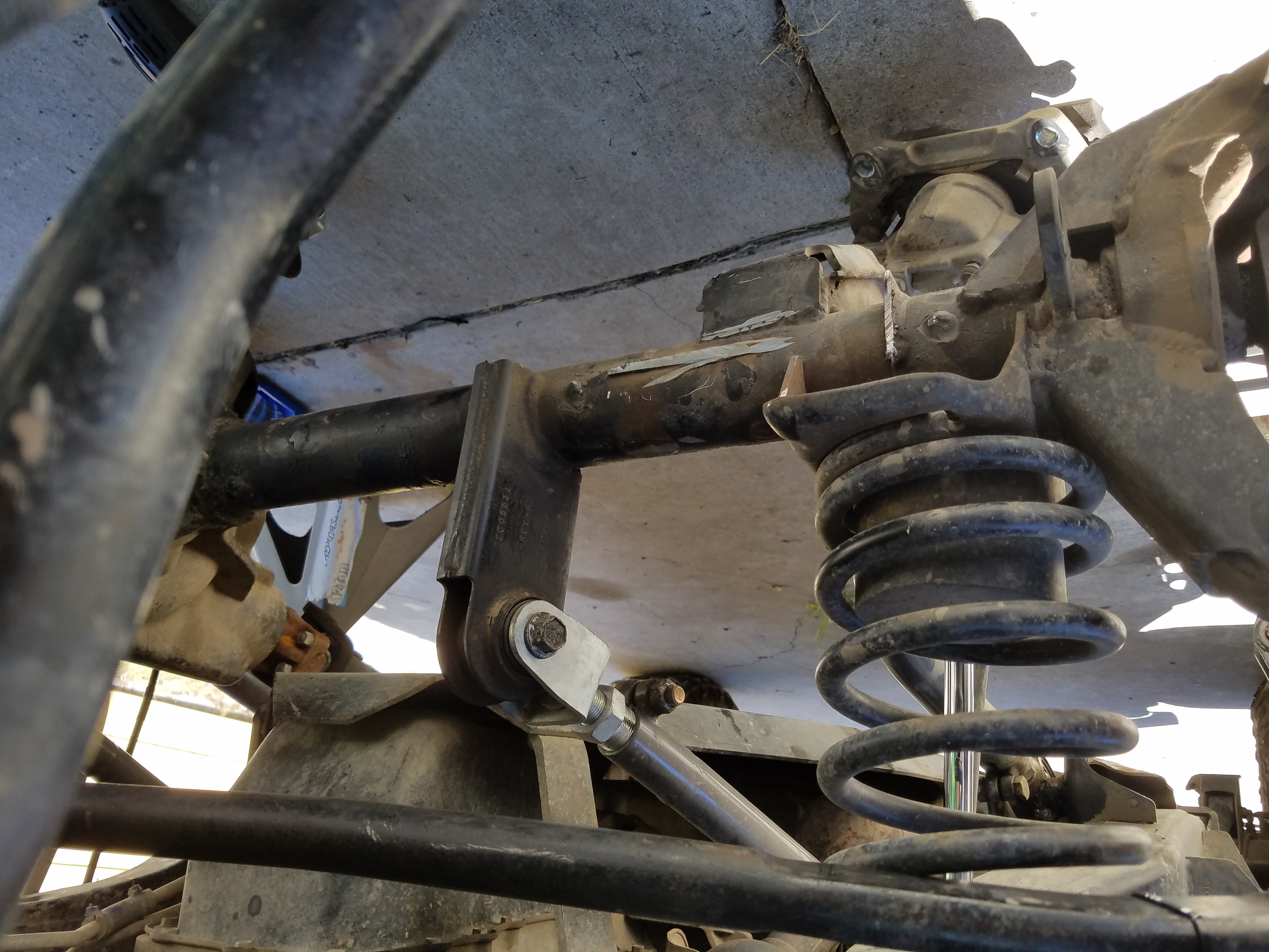

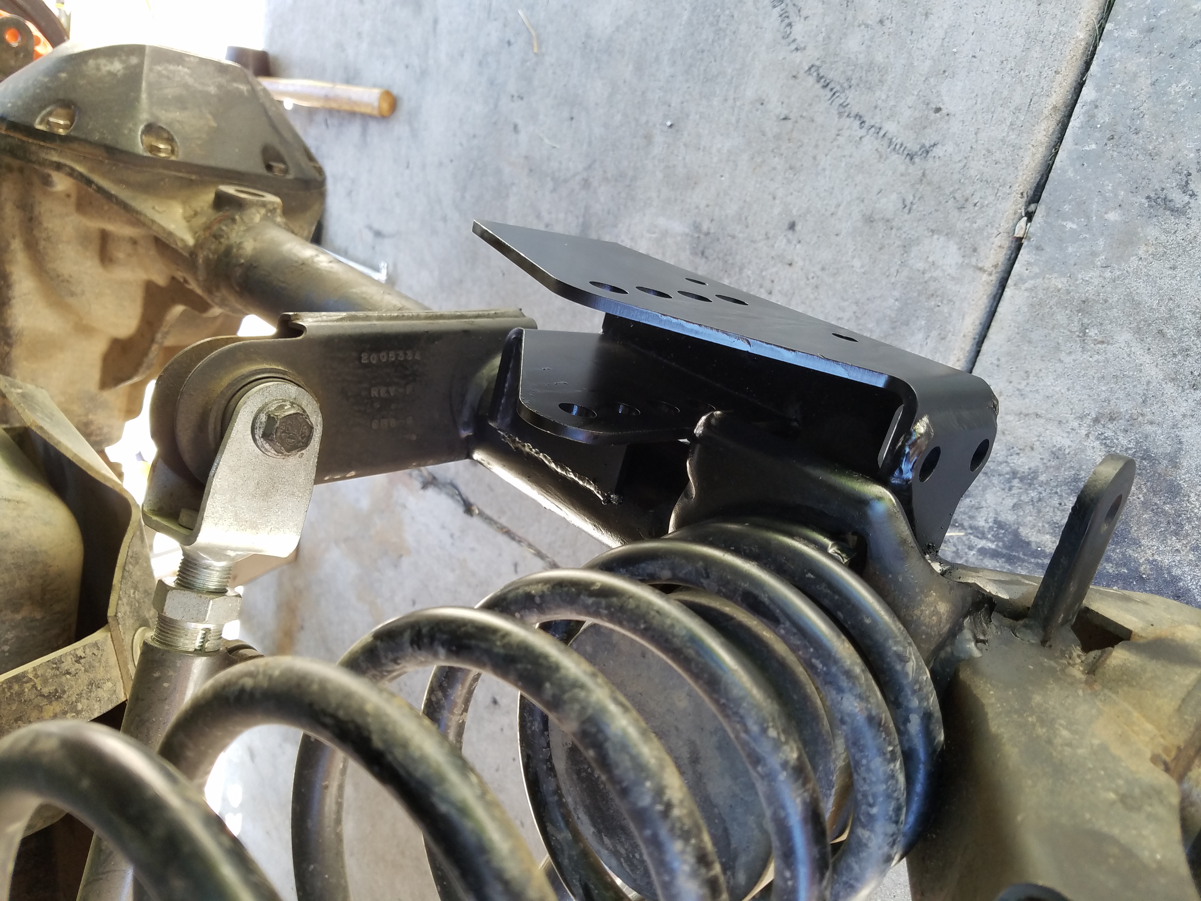

With the Reids having a flipped drag link, got rid of the thin battered stock track bar bracket for a raised weld on version.
