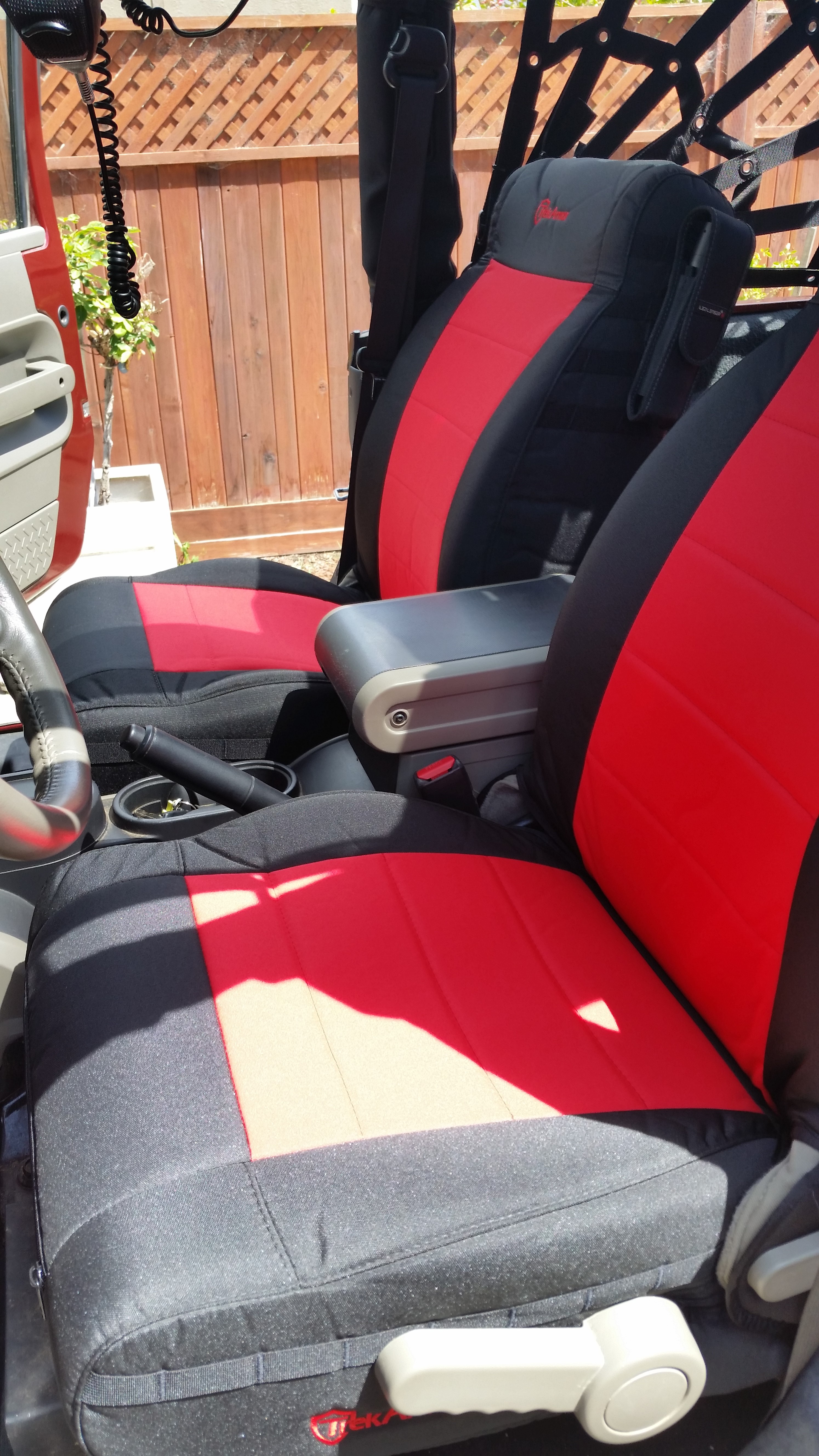

After the last wheelin' trip and covering the Jeep inside and out in mud. Decided to get some seat covers. After researching on the web and reading the great "JK Forum" posts on the subject. Went with some Trek Armor covers. Red on black.
Waiting a few weeks before cutting the holes for front headrests as suggested on youtube vids.
