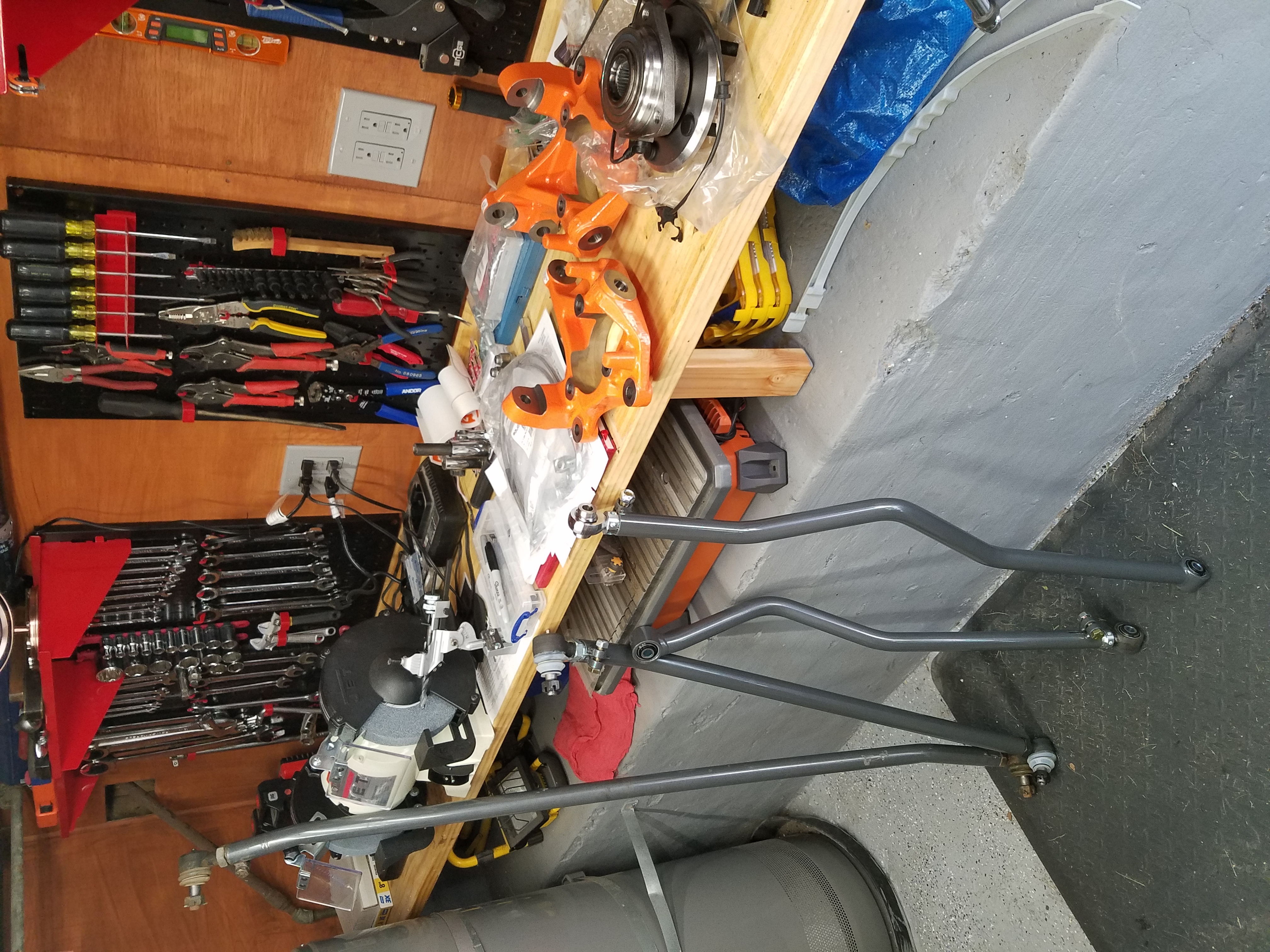

Connecting it all back together with some Synergy DOM tubing of various lengths,shapes and bends.

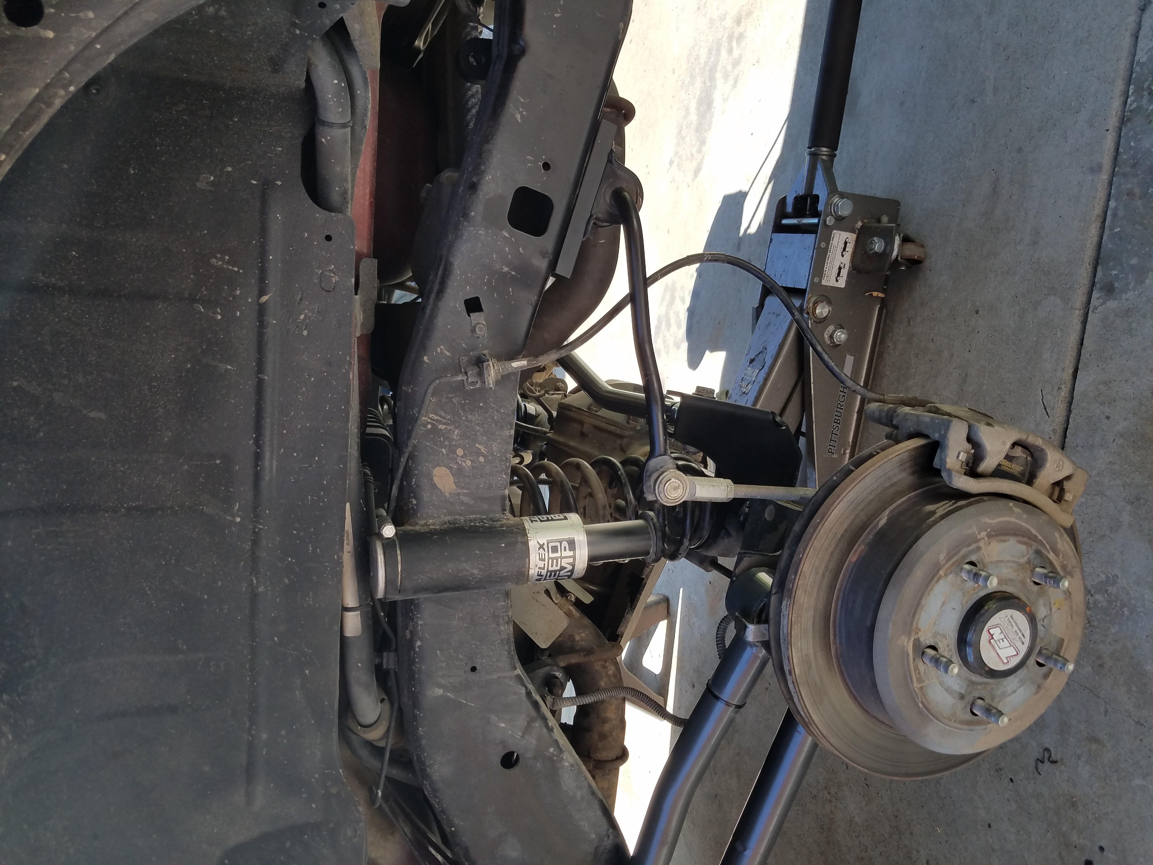

After hitting a shock reservoir with a rock and sending it into the swaybar. Decided to move the swaybar back and out of the way. Also now square to the axles, not forward.
Shocks sent back to fox for a service and to replace short lines with 16" versions to allow movement of the reservoirs and mounting on the rear crossmember.

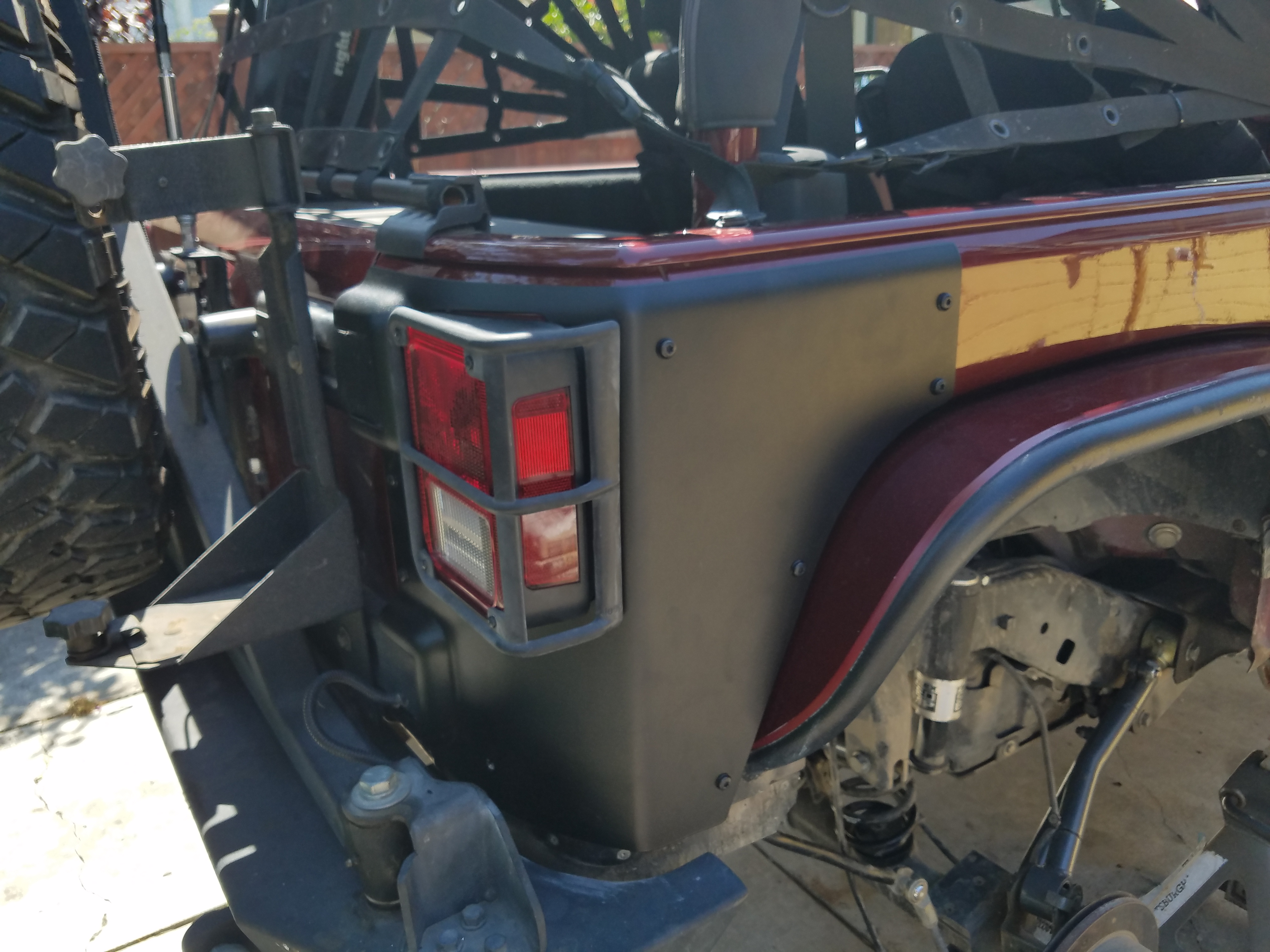

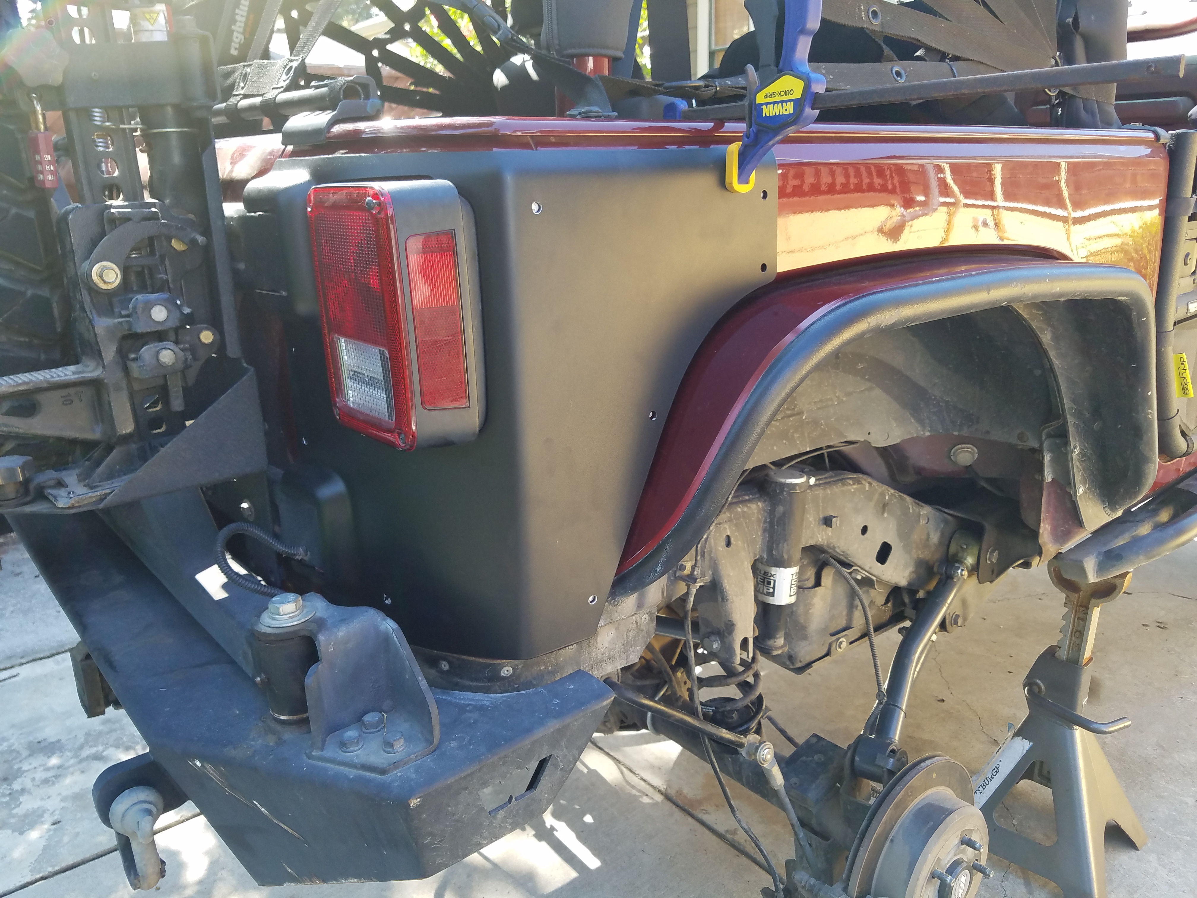

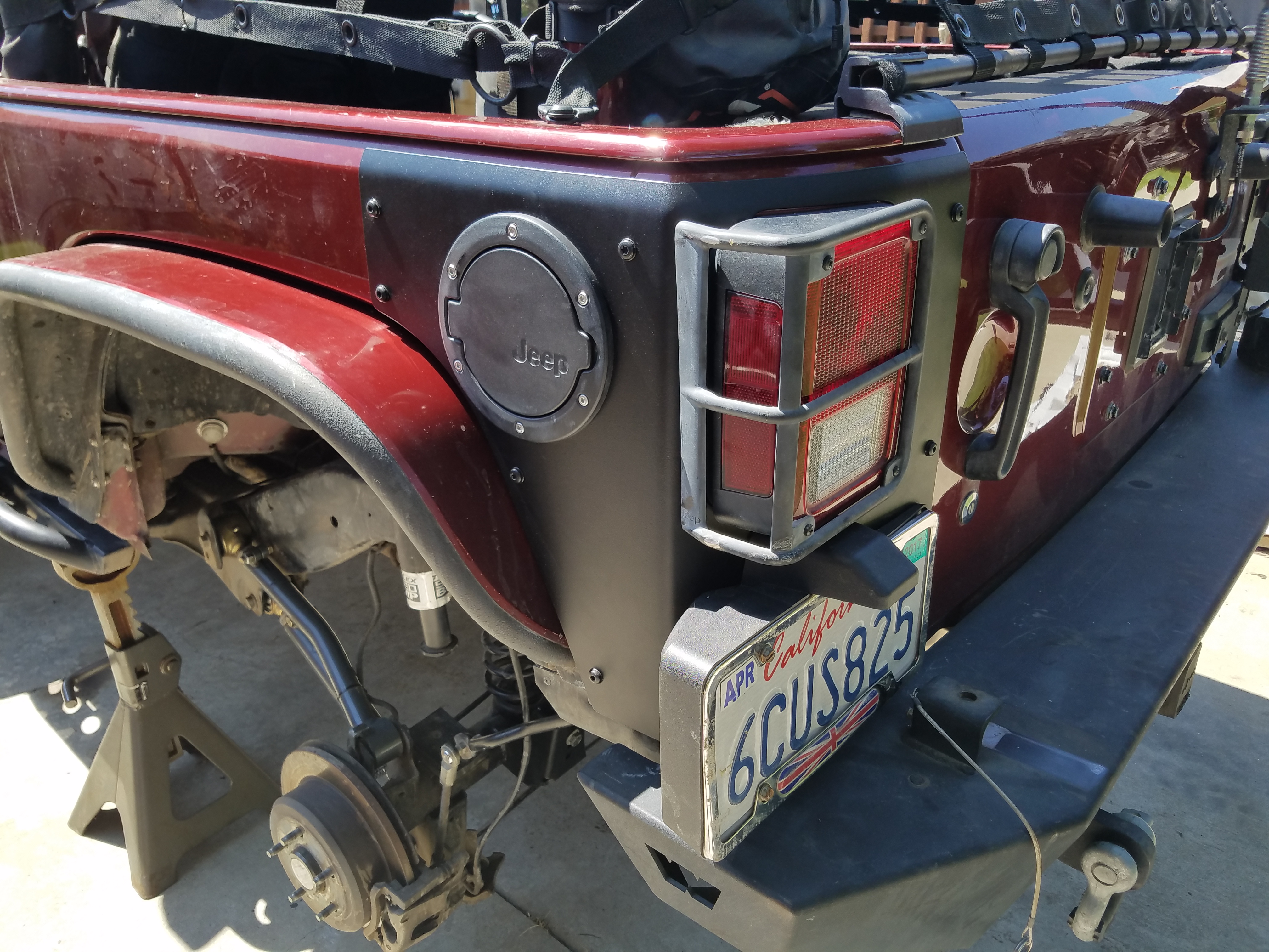

After hitting the tree on the Rubicon and killing the license plate holder. Invested in some AEV corner guards.
Lined up very nicely with the body work, quality product.

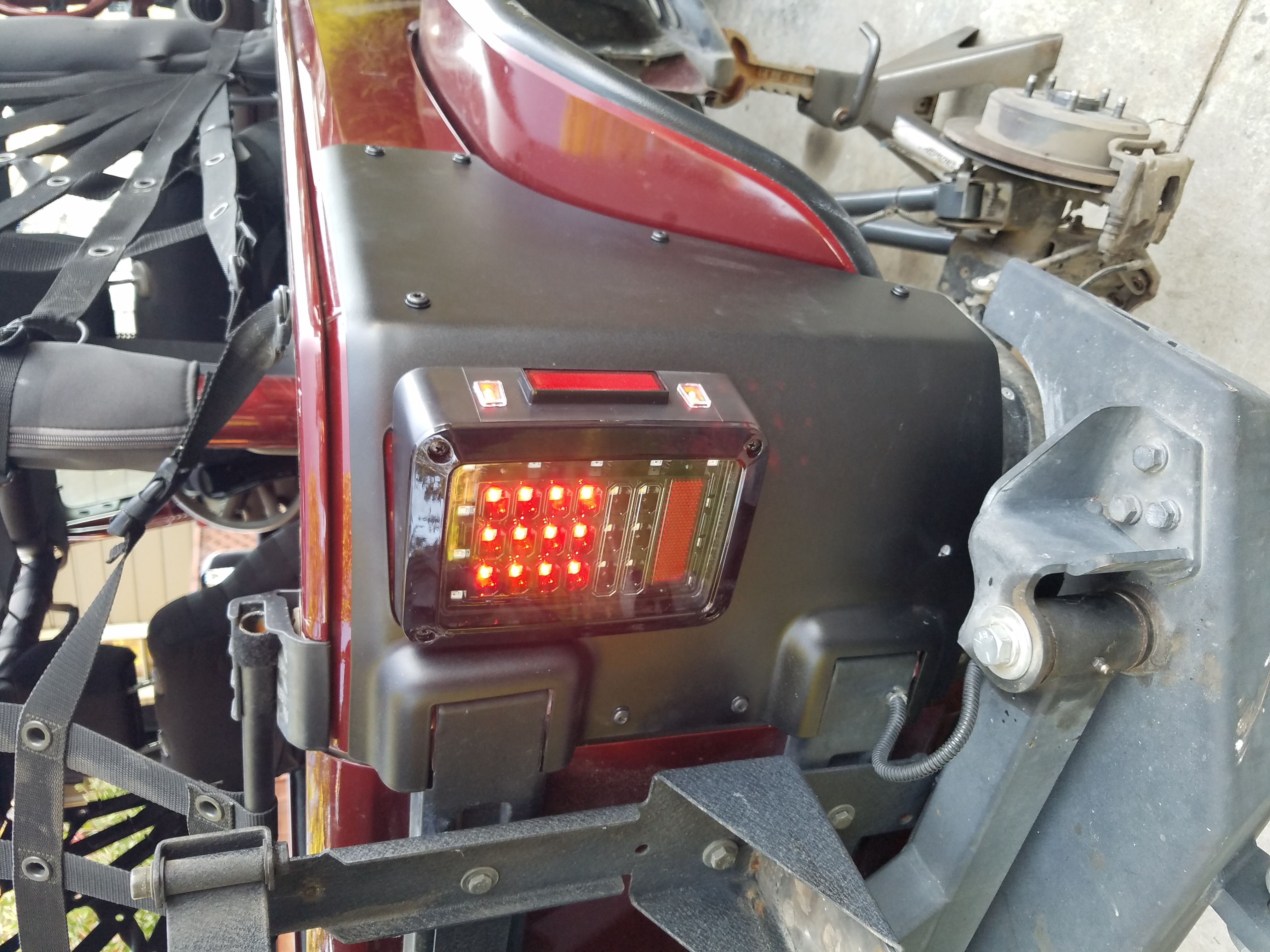

Found a set of Xsprite LED lights on Amazon at 1:15pm. Went for it.
By 6pm they were delivered and installed. Got to love Amazon and Brown Santa working in harmony.
Decided to give the light guards a fresh coat of rattle can black also.

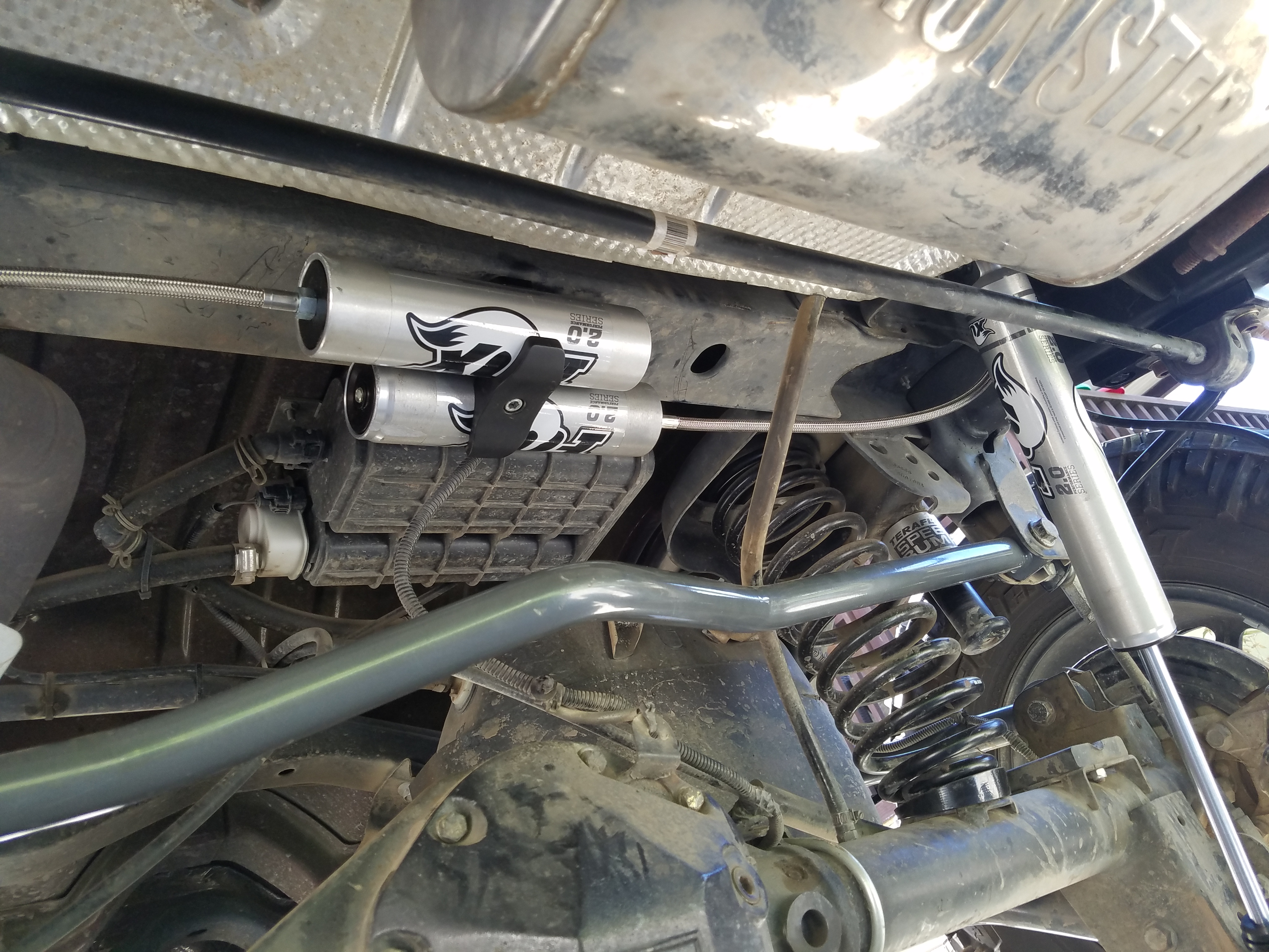

So the rear shocks came back from Fox with the extended lines.
Also got some schrader valve end caps from Ryan at Accutune off-road.
Mounted the reservoirs up on the crossmember and out of the way
