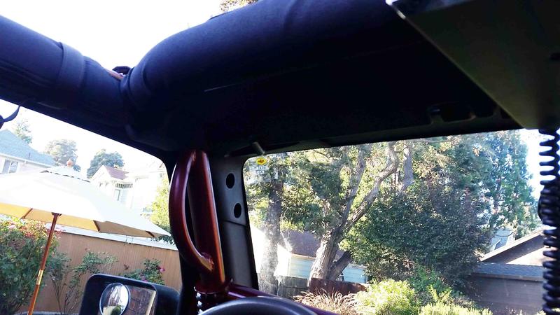

Went with the KC light clamp as a CB mount idea.
Trimming and fitting the A-pillar corner plastic, was a time consuming process but worth the effort (I think anyway)

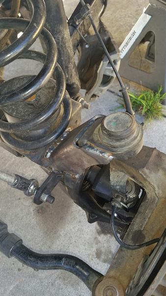

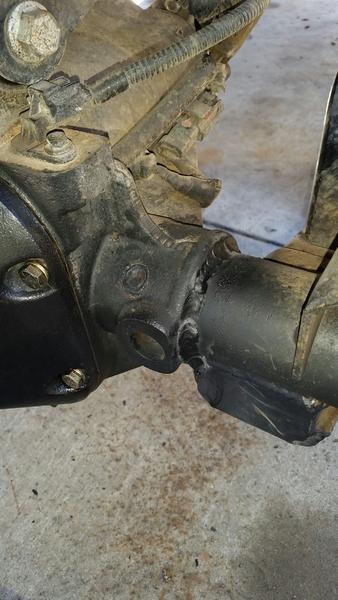

C Gusset install and axle tube to diff housings welding.

Front axle tubes.

Rear axle tubes.

Used 44-30 wire for the tube welding. $80 for 2lbs, but no chance of cracking during shrinkage. Welded each tube in 4 sections allowing plenty of time to cool down in between.
Had to grind the inside of the AEV diff skid to get the perfect fit back.

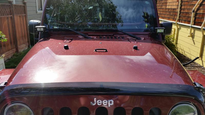

Bolted down with some adjustments to stop the hood dimpling too much at the bolts
Fitted back on the Jeep.
