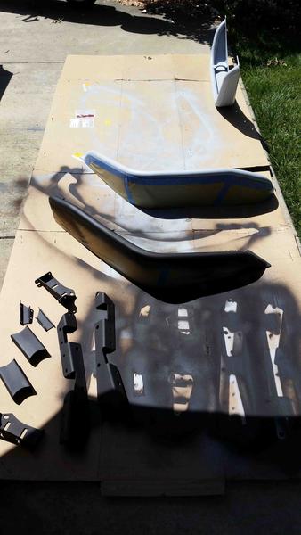

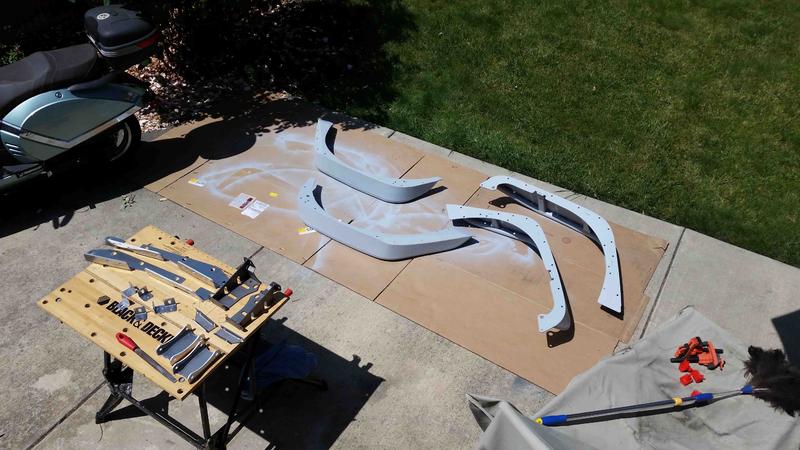

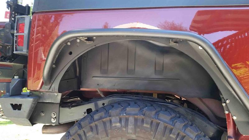

Time to do something with those fenders and a little more armor. Decided to go with a set of PSC Front and Rear Crusher Flares in Alum. and let the painting begin.
Powder coating would have been so much simpler.

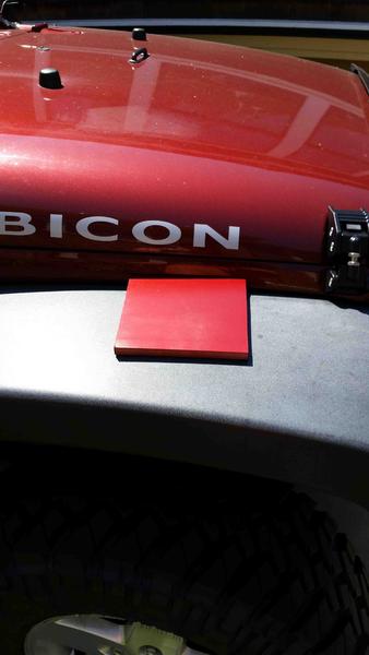

A color match check

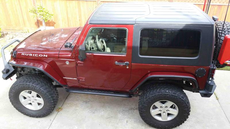

Some clear coat and time for the install.

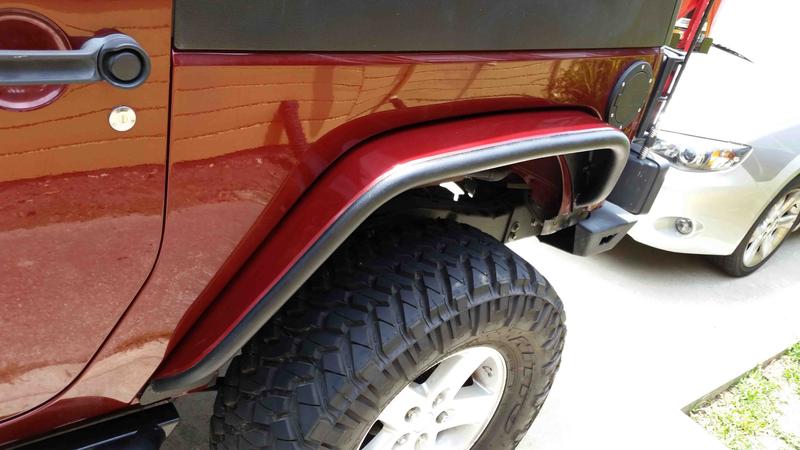

The stone ringing from inside the back wheel arches was solved by using rubberized undercoat with a layer of black enamel paint over the top.

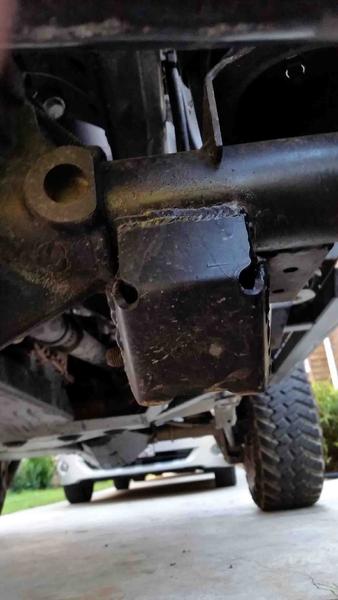

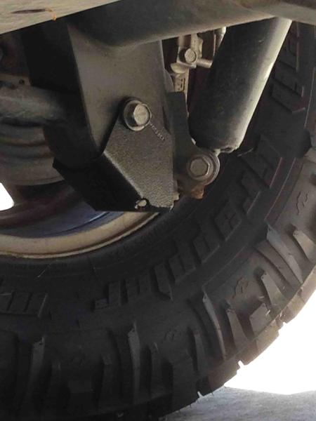

Added some control arm skids front and back

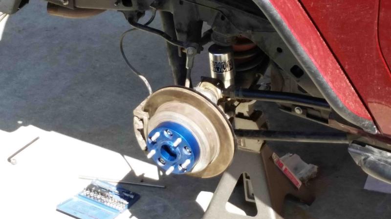

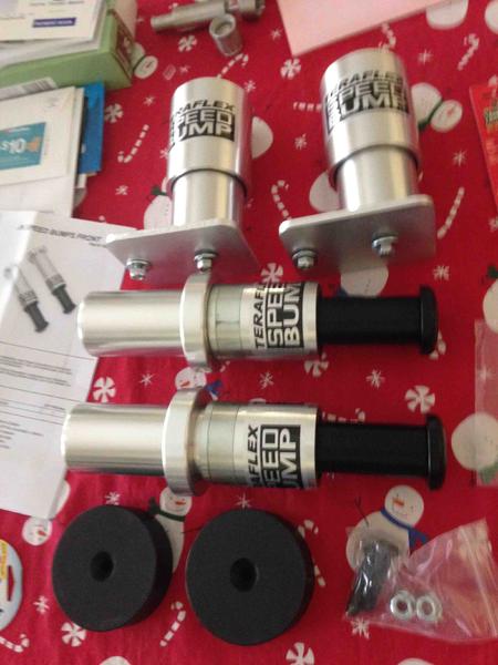

Now too get rid of the hard knock bump stops with some Teraflex Speedbumps
You may ask why Speedbumps and not King Air stops, well the $700 v $1150 price swayed the selection, and I don't plan on doing any fast stuff until the axle swap and coil overs, then I will probably change. (Plan on pushing that KOH envelope limit as far as possible )

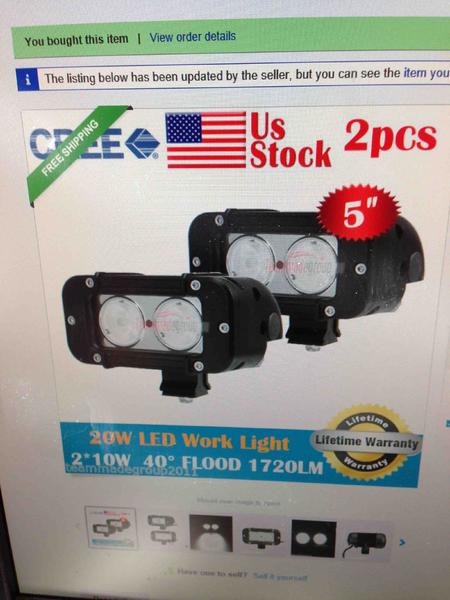

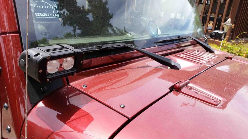

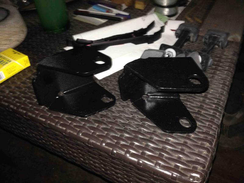

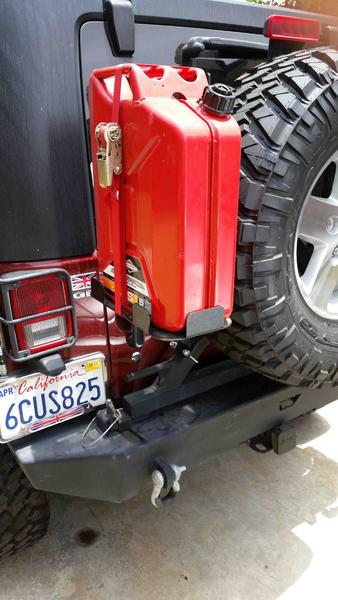

Few more mods. Gas Tank holder, High lift mount and a some CREE LED spots.
Found these little gems on ebay, $50 a set. 2 10W CREEs in each.
Rockhard 4x4 gas can holder fits perfectly on the WARN tire carrier.
