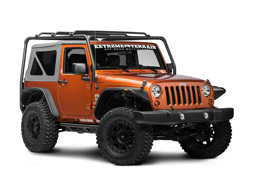

All great points! I sure appreciate it! Trust me when I say that I have my reservations about loading anything more than 50 lbs on the stock hardtop. It's one of the reasons I prefer to load my mountain bike on the back of the Jeep. I don't want to incur any flex on that top. That's why another option I've considered is an exoskeleton style roof rack that mounts to the body/frame. The Gobi and Garvin racks look the best, but this Barricade one seems like a great buy at $399.99.
Thanks again for the tips
