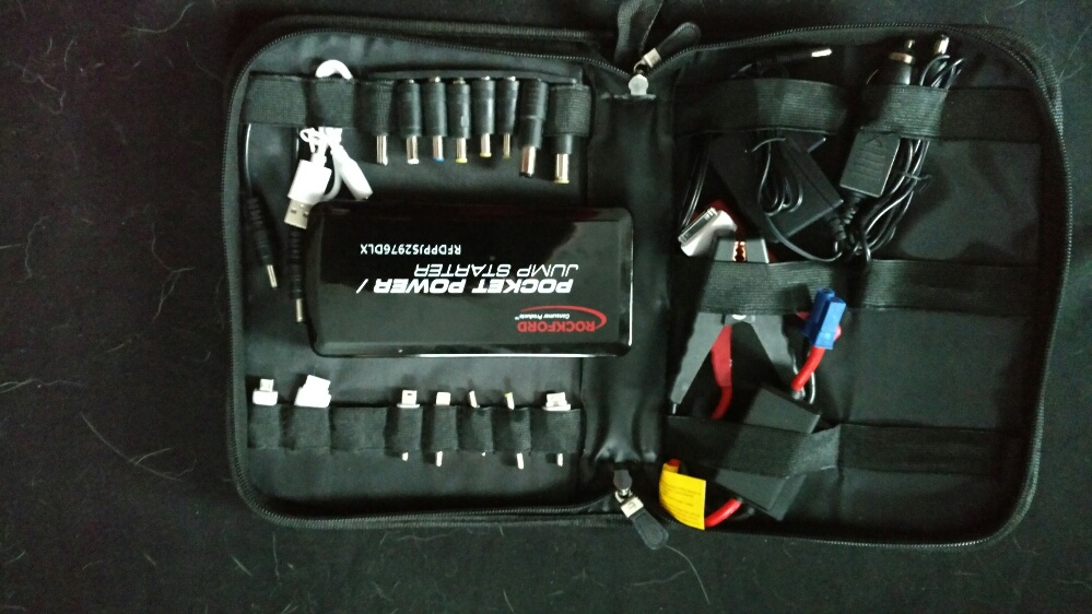

The portable Lithium-Ion "Jump Pack" would lend itself to a voltage source. They are intended for charging/ running all sorts of 12v devices, as well as providing jump starts.
I keep one in my JK for those who might need assistance with a weak battery. Click image for larger version
