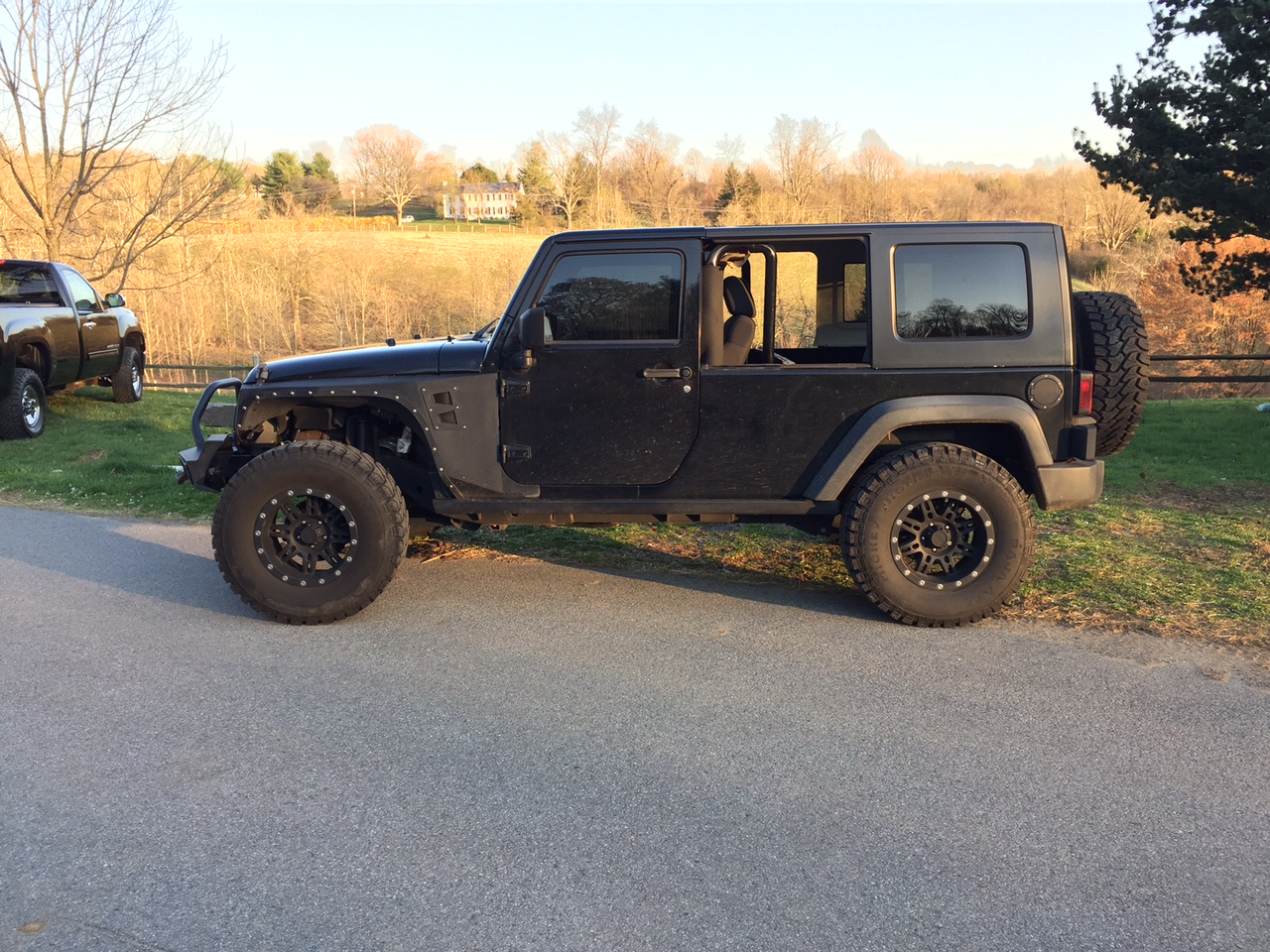

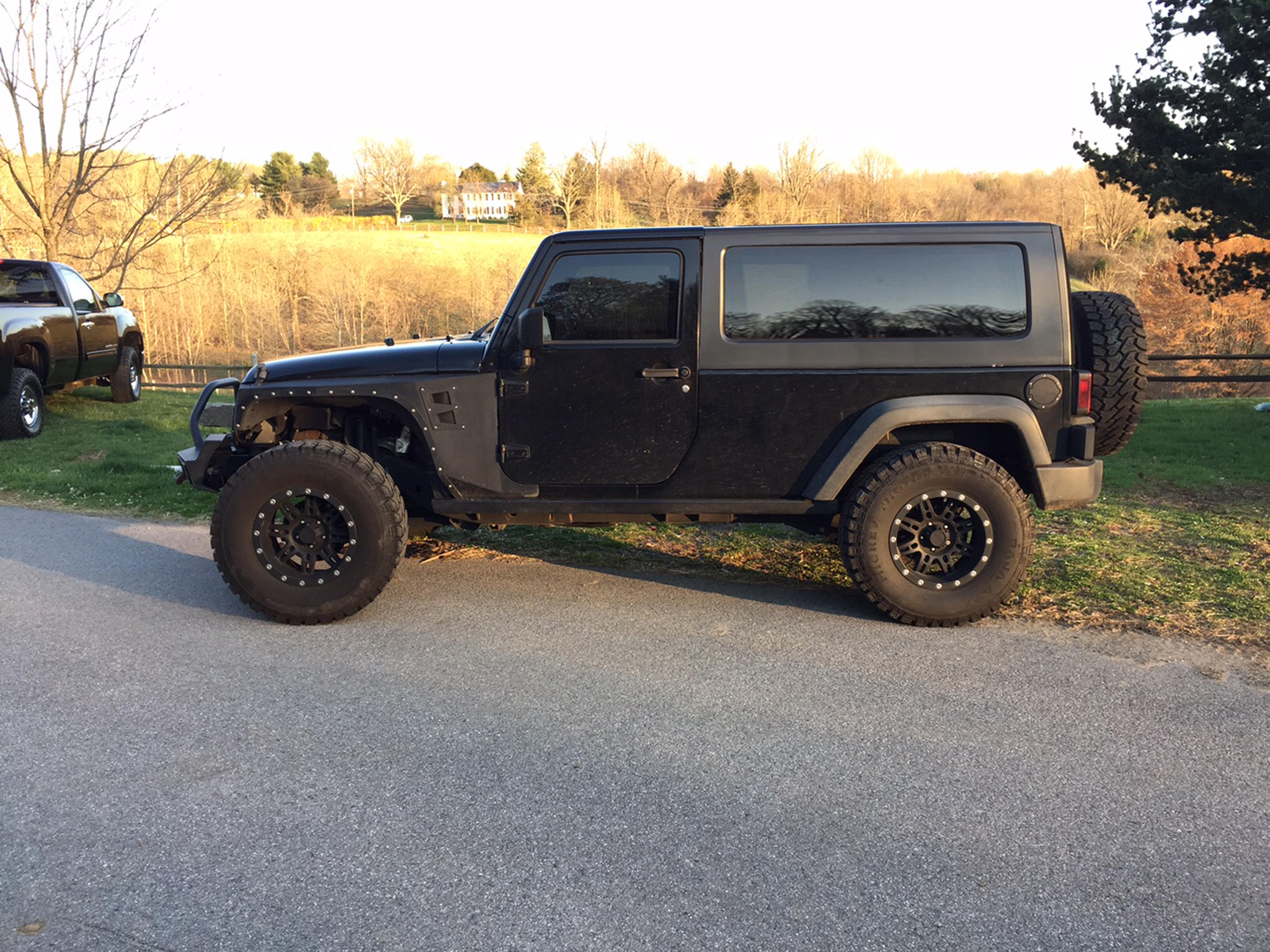

Over the last few years I have read many of your threads on various sites and the innovation and work product is quite impressive. I have a JK8 and I want to build a full length hardtop as in the photoshopped picture below. I have a 2007 4 door hardtop and a 2011-up 2 door hardtop that I bought with the hopes of fabricating a full length hardtop for the JK8. Do you have any design concerns with what I would like to do? I have not figured out how to handle the glass. Ihave considered a slider like you have done or possibly a fixed window with a small vent window at the rear. Any advice you could offer is appreciated. I hope to start cutting tops in a couple weeks.
As you notice in the picture, the JK8 conversion removes the b pillar and that is why I bought a 2 door top so that I would not have to completely fabricate the leading edge of the side panels. Thanks

That sounds like an interesting hardtop project, and one that's not too difficult with proper design and planning.
It's hard to cover everything about the project in a single post, but I'll start with some general comments about what I would do if I were doing the project.
First, it'll be a big thing - hard to handle to take on and off. Maybe not technically bigger than a JKU hardtop, but the extra length in the side panels will make it heavier and more awkward to handle, so I would convert it into a modular top. I've documented the modular conversion in detailed steps designed for a DIY-er to be successful with, if you haven't read the thread I highly recommend it, even if you decide not to go modular the thread has a lot of tips you'll need for deailing successfully with SMC (the fiberglass variant that the top is made of). That thread is here: Converting a factory JK/JKU hardtop to modular
In addition to making the top easier to handle, making it modular will enable you to run without the side panels, or with roll-up soft sides, so you can gain some very nice functionality by going modular.
About windows, there are several ways you could go:
- Custom sliders. There are a few companies that do one-off custom slider windows, and for a pair to fit these long sides, you'll probably spend at least $600 for two windows. Those companies won't do windows that match the slight angles of the front and rear verticals of the hardtop window opening, nor can they do a sharp enough radius to match the radius of the opening in the hardtop, so at best they won't look factory.
- Custom-fit safety glass or tempered glass windows held in with window gaskets. Safety glass will generally be a very light green in color, alnmost transparent, but it's a little less expensive than tempered glass, which can be made in various tints.
I used safety glass in the LJ Safari Cab, and I used tinted tempered glass in the JK Safari Cab to match the factory tint. Pictures of noth are below. It's not too hard to find a glass place to do custom cutting of the glass to exactly match your openings.
Doing a single window on each side will result in what I'd consider to be an awkwardly-long looking window, so I'd break it up into two windows, maybe something like one of these ideas:
If you do something like the above, it's not to hard to make a vent window that opens, and not too hard to power it either. I did powered vent windows on the JK Safari Cab and I really like the additional ventilation they provide:
https://www.youtube.com/watch?v=KytfmQV7Lb0 A problem you'll have to solve is that any of the above glass options require a flat mounting surface for the glass; the factory glass mounting surface is curved. You'll have to modify the side panels to provide a flat mounting surface. That's actually not too hard, I can walk you through the steps on how to do that.
I could write a lot more about the details, but what I write will depend on what you decide about what I covered above, so think about the options and see what appeals most to you. I'm happy to provide whatever additional details you need and help you every step of the way. Feel free to ask as many questions as you like, I'll do my best to answer them.
