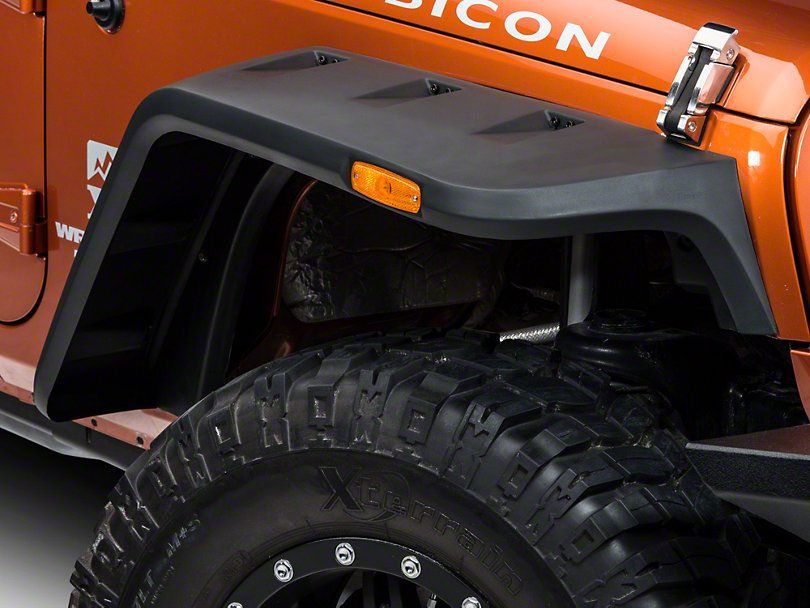

The Hurricane fenders are ones I put in the "almost flat" category - I don't like where the bolts go and the top isn't flat because of the grooves for the bolts. Also I think they're a plastic that doesn't take paint well and they have a grained texture, so you couldn't color match them.

They would fit very much like the Hurricane fenders pictured below, but with a few differences. The tops of the Hurricane fenders start a few inches back from the grill, and slant back from there. Mine would start even with the grille and like the original flat fenders, wouldn't slant back - they'd be straight across the front. And of course mine would be perfectly flat and level across the tops, the Hurricane fenders slope down towards the outside.

Like my TJ version (and the Hurricane fenders) I'd put a flush mounting location for a side marker light in mine, unlike the Hurricane mine would be designed to accept an original CJ-7 side marker light as I did on the TJ version.
