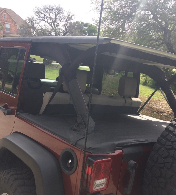

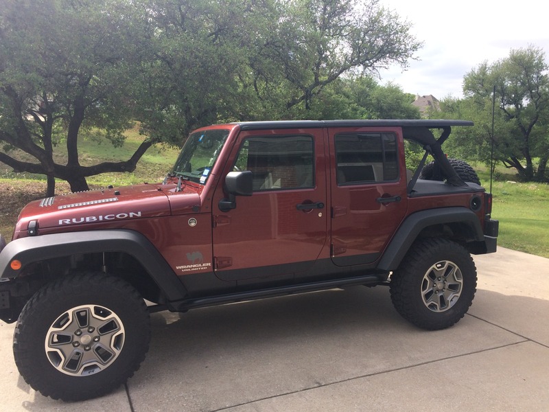

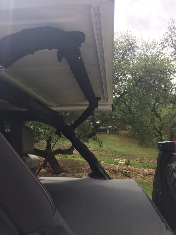

Jeff I purchased a rear section factory 2015 4 door top that was slightly damaged on one corner and was originally factory painted gloss white and cut it to pattern like you have done to make it modular. After painting it and fabricating some mounts from exhaust hangers and clamps, used a shelving rail to the rear section for structural support and purchased a rear accessory bar from Rockhard 4x4 and some roll bar wrap covering I mounted it. It is solid and keeps the wind noise down while doing 80 on the highway. I plan to make it modular later on but primarily made it for warmer weather. It is very easy to put on and off and storage is simple as well. I had wanted a hard "bikini top" for a while and your instructions on making a modular top made this come together.
Attachment 670756
Attachment 670757
Attachment 670758
Glad my modular conversion instructions were helpful to you!

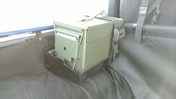

I decided that it's simpler for me to make a tray, so here it is.
I don't really need a vertical foot for support, an "L" bracket through -bolted to the hardtop/ body lip works to support this tray I salvaged. I'll add a Vertical if I decide to carry anything heavy. Note ; if drilling through the drivers side lip, move the wiring harness out of harms way.
The Ammo box carries "Emergency Repair" supplies , and gives Dog Proof storage.
This is a light-duty application, and works for me. Inspired by this thread !Click image for larger version
