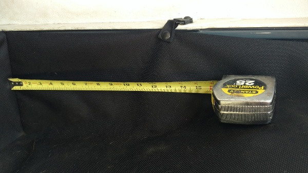

The scratches in the glass, on the inside, are visible, and you can feel them with a fingernail. Reflections in the glass don't allow a pix. Dogs !
The fore and aft length for me, 2 dr , rear seat removed, is 13" for the Ammo Box Carrier.

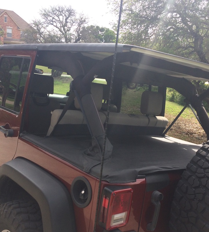

Originally Posted by jscherb
Yes, it could be run as shown in the photo below. The back is being supported by the brackets to the roll bars. These brackets support the rear of the roof rack, but also can serve to support the roof without the vertical supports or rear panel in place.
The JK version of the Safari Cab has similar roof rack support brackets in the rear, so it could be run the same way.
I don't run the tops this way and if I were to do it I'd probably make a minor change in the brackets to improve the side-to-side rigidity because as they are now they are mostly for vertical support, but that would be an easy change to the brackets.

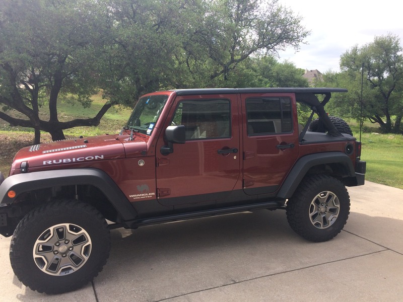

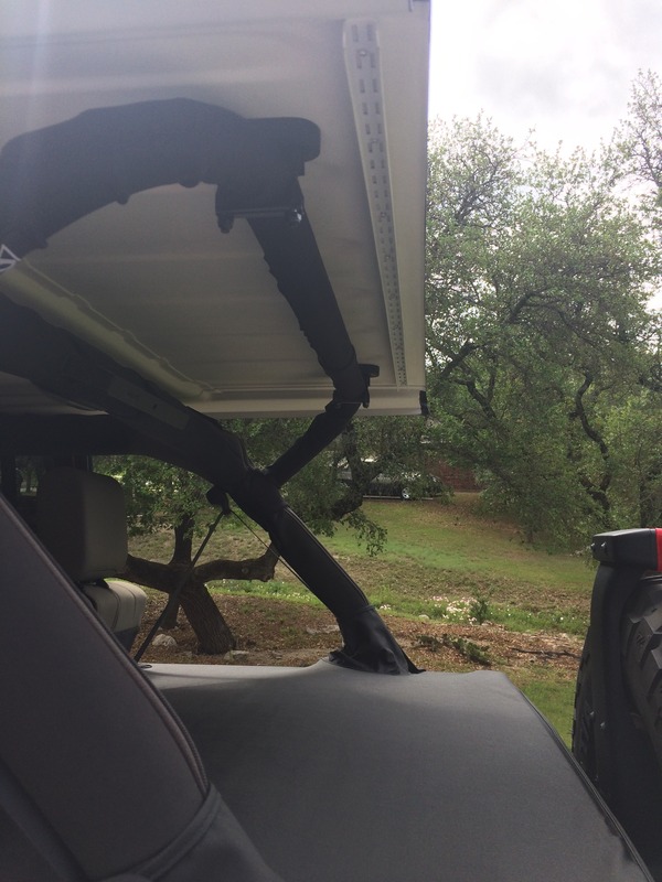

Jeff I purchased a rear section factory 2015 4 door top that was slightly damaged on one corner and was originally factory painted gloss white and cut it to pattern like you have done to make it modular. After painting it and fabricating some mounts from exhaust hangers and clamps, used a shelving rail to the rear section for structural support and purchased a rear accessory bar from Rockhard 4x4 and some roll bar wrap covering I mounted it. It is solid and keeps the wind noise down while doing 80 on the highway. I plan to make it modular later on but primarily made it for warmer weather. It is very easy to put on and off and storage is simple as well. I had wanted a hard "bikini top" for a while and your instructions on making a modular top made this come together.

Here's a pix of where the side carrier would go in the 2dr . Because I have a Cargo Liner, and use the well behind the front seats ( Rear Seat has been removed from mine), my space requirements are atypical.Click image for larger version

Here's a pix of where the side carrier would go in the 2dr . Because I have a Cargo Liner, and use the well behind the front seats ( Rear Seat has been removed from mine), my space requirements are atypical.Attachment 670771
Based on your measurement it looks like the width might be enough for the production version of the mount.
But - the mount has feet that sit on the floor, so I was wondering how much floor is under where the mount would be and how much of the mount would be over the seat well. The feet can be extended so if they need to reach down into the seat well that'll work, but would help to know how deep they'd have to go.
